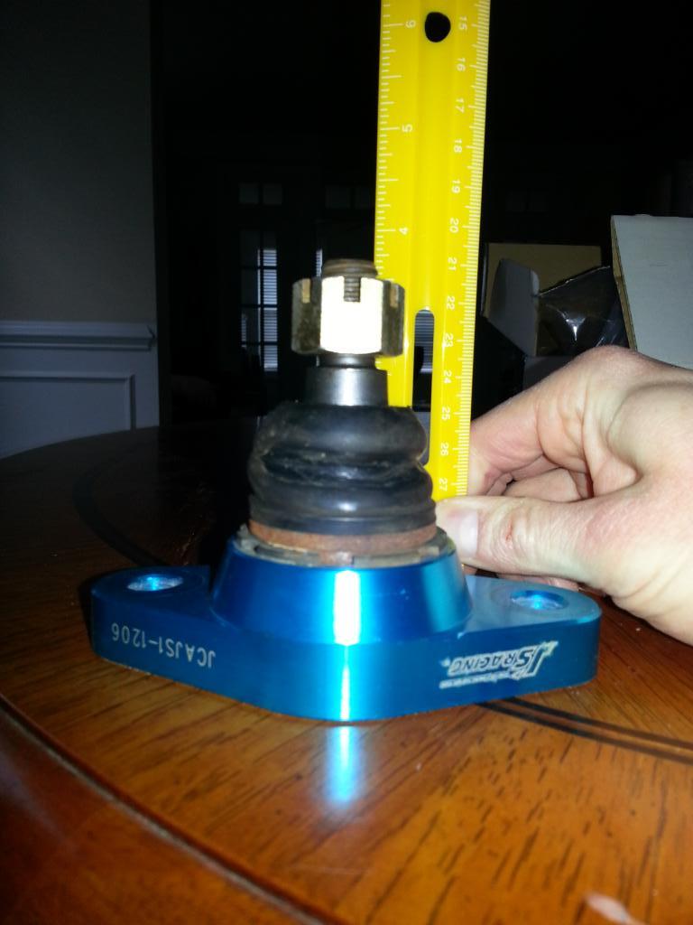

Lets say there were no other options available.. Could you just shave the base to remove the RCA?

What's the max camber you can get with the Hard Race (Megan Racing) camber ball joint? They don't seem to specify that on the website.
The base on these don't look thick enough to shave down:
It's not the base thickness resultant strength that would be the issue. Most likely it's the same material that these are milled from, and so if they are modified to the previous design's geometry, they will have the same strength. Your statement implies that the original design is not strong enough. Is that what you meant to say, or do you know something about stress design that others who use them successfully don't?
I think the bigger issue will be determining what they have done to locate the ball joint and whether it will allow modification. Is it retained with a circlip? Is it pressed only? or is it taller and bottoms out at this new depth? all of which could keep you from successfully returning the ball joint stack height to stock dimensions.

That's right, except with the new design they didn't just add material to the bottom, they extended the ball joint further up(down on the car). The base is the same thickness as the old S2 and factory so you reuse the factory bolts.
[/quote]
Foot meet mouth. That's a bummer.
