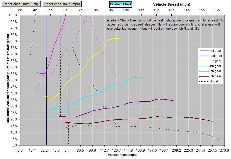

Numbers did not follow what I had. Here is my calculations. I drew a line between what I think are the gear matchups. In the lower gears the Porsche has a significant advantage, but as the speeds and gears increase it is erased.
Here is a neat program that I put all the data into. Takes into account gearing, HP, etc...
http://www.lpiracing.com/store/pc/public/calc_v2_2.xls

I failed to notice the dyno you provided Blackey was listed as "flywheel hp". Since it was a dynopack, I figured it was the straight hub values - were they multiplied up to estimate flywheel hp? If so, then they are probably about 15% high over what I would normally use to build a graph - if they are straight hub values, then they are probably about 5% high.

straight hub values

Mark, this is simply an error of semantics on behalf of the dyno manufacturer.
The number represents the power the dyno is measuring, which as Bill stated is at the hubs. So there are further losses due to tire fluctuations etc. that are not accounted for.
The easiest way to settle the delta between where you measure your numbers and where we measure ours, is to run both cars on both dynos. I can make arrangements to bring Ry's car to Dyno Spot Racing as they are a reputable Dyno Jet facility, one that you are probably familiar with...
