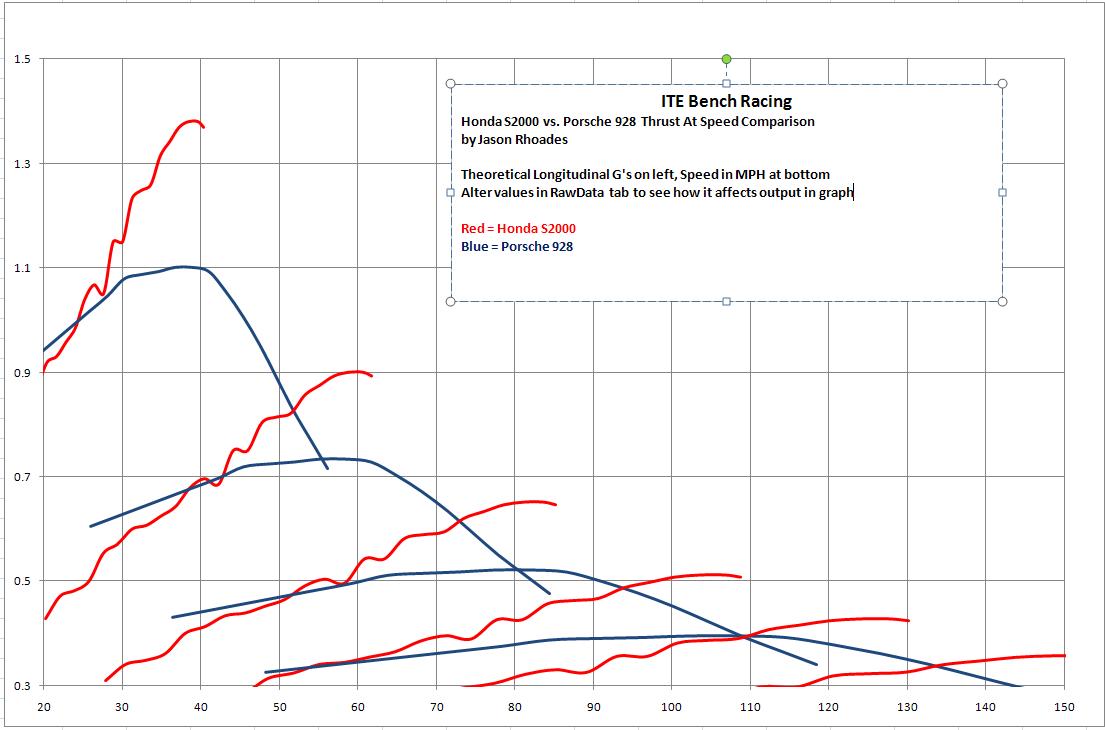

I have a template that I've found useful many times for these comparisons. Sometimes a graphical explanation is the easiest to understand, forgive me if your graphs weren't doing it for me Mark.
Since you didn't provide a dyno I had to make up some numbers to round out your dyno based on your colorful description. The S2000 numbers being from a Dynapack are likely a hair inflated.
The spreadsheet is available here:
http://www.jrho.com/ITE.xlsx
Here's the output of the analysis - basically, the higher the line, the harder the car is accelerating at that speed.
Actual measured acceleration for a data logger will be lower than these theoretical values due to mechanical drag, the percentage difference increasing with speed due to aero drag.
Here's what I see:
Below 25mph it's a tough call, no good data from either car. The 928 has a really tall first gear, and the S2000 has no bottom end.
From 25-40mph the S2000 appears to have a pretty big edge. However, in my experience, production cars on DOT tires set up to turn are generally limited to more like .8-.9 longitudinal G at best, so things are probably a wash there.
From 40-low 50's, the 928 has the edge, and appears geared well for the amount of power available; it should be able to go flat-out in first without spinning the tires too much.
From ~52-~62, the S2000 gains a definite edge, right in the meat of its powerband in its short second gear. The 928 is at its peak torque here, but its tall second gear makes it meaningless, except on slippery tracks, where the S2000 might not be able to use full throttle.
From ~62-~73mph, the 928 regains the edge, still chugging along in second gear, while the S2000 has had to drop to third gear.
From ~73-~85, the S2000 regains the edge, a very healthy and consistent one, pulling through the meat of its third gear powerband, while the 928 is either wheezing to death in second, or in the meaty part of its "merge onto the autobahn" third gear.
From ~85-~94, the 928 has the edge once again, though the edge here is pretty small over the S2000, now in fourth, climbing into its powerband.
From 95+, the S2000 checks out, plain and simple.

Feel free to download the spreadsheet and play around with the gear ratios, engine outputs, or vehicle weight to see how it changes things.
