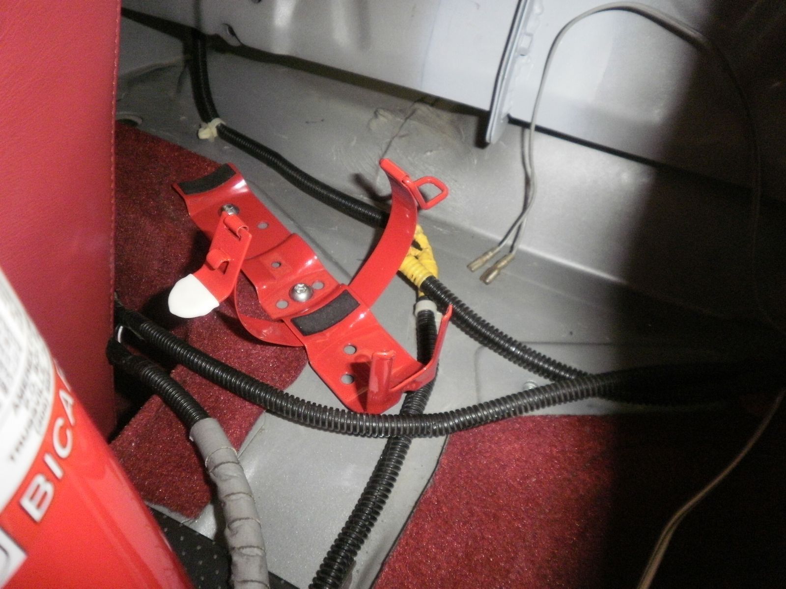

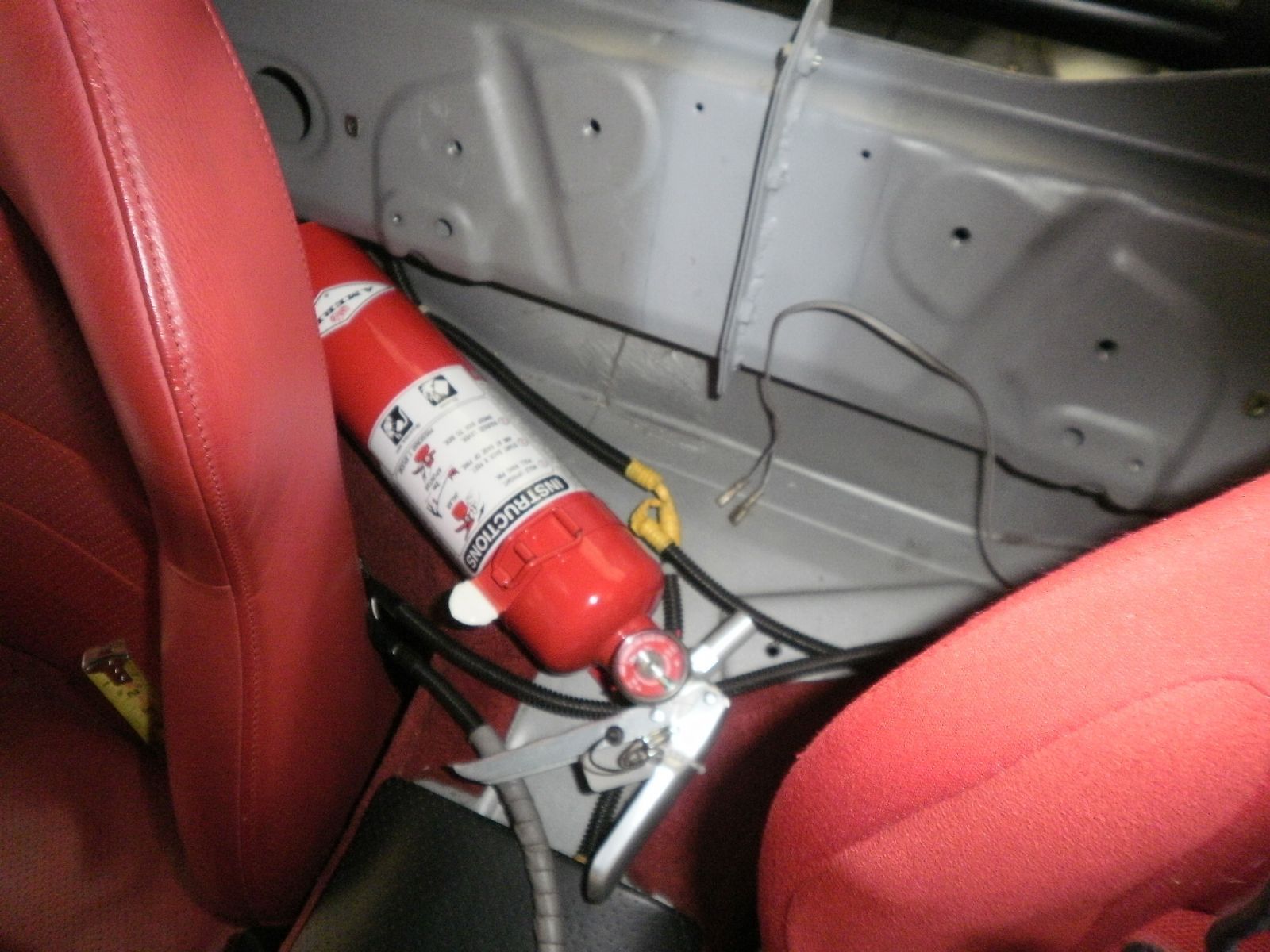

For those running Redline Time Attack, how did you mount the fire extinguisher without hacking up the interior? post pics please

Two small carefully drilled holes and bolts with nylock nuts.

On my race car I used self tapping screws that were a few centimeters long. Did the trick and went in easy

I mount it on the cross bar roll bar behind passenger seat. Check with you track rules, it might not pass the tech.

Some regulations require backing nuts / plates.

I used the stock roll hoop's threaded holes, very solid, no drilling.
