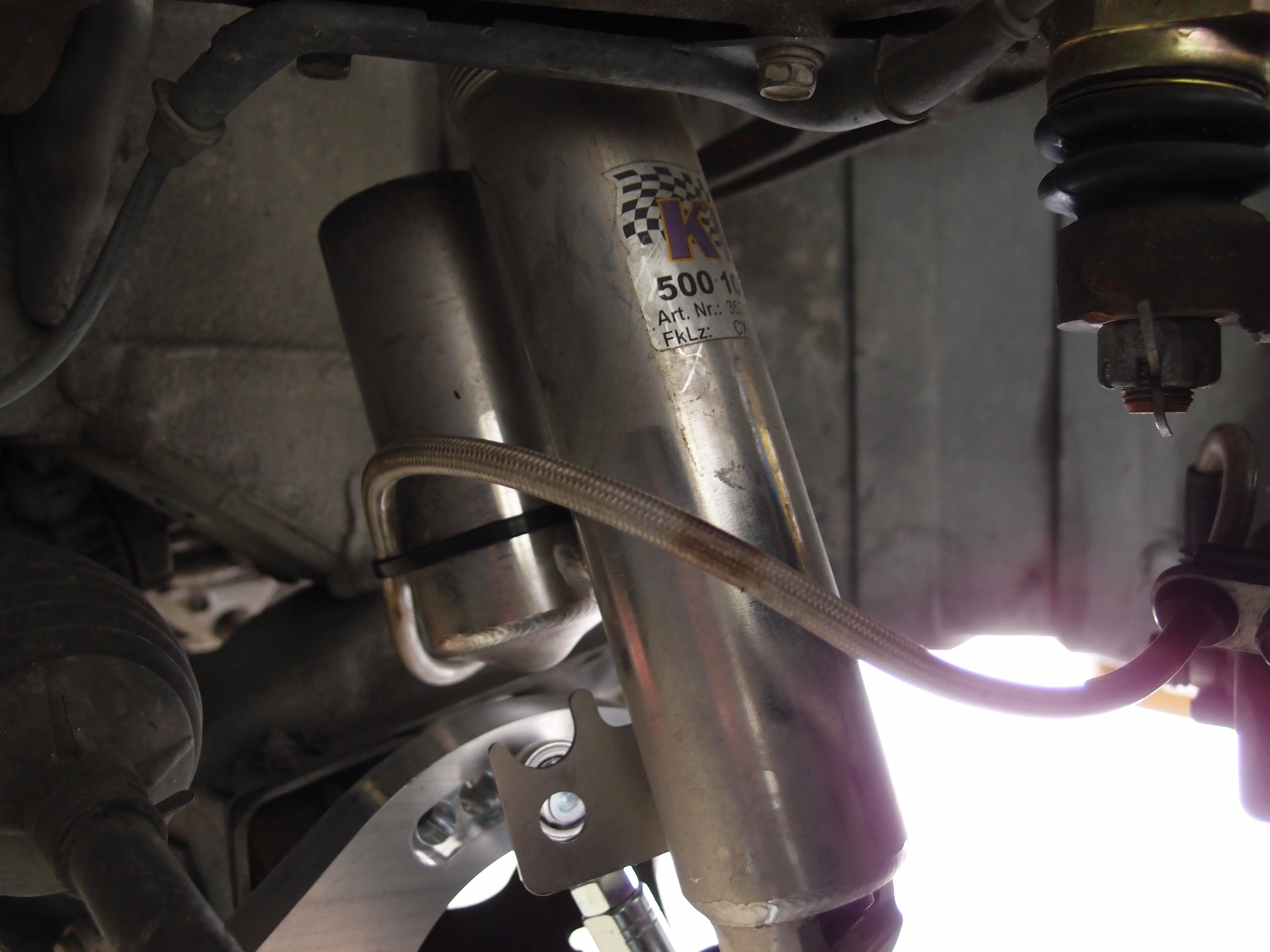

I listened haah but just like to get more opinions since I see alot of people running moddiction or eibach for the track while karcepts seem to reign supreme in autox. Also, are you able to just bend the bracket or am I better off just cutting it off? where to relocate brake line?

its been an issue with the kwv3. if you can bend it i guess why not. honestly i would try reversing the shocks so the line points the other way? like how the manuals states to do with the stock shocks.

I don't think there's enough room in the front since v3 have a "external reservoir"

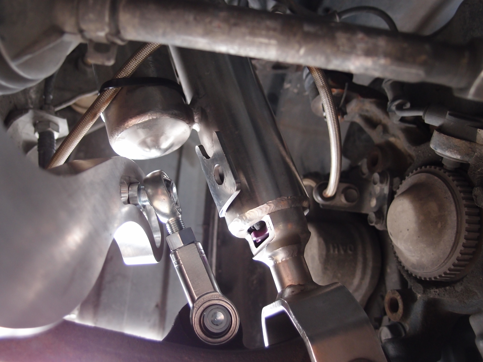

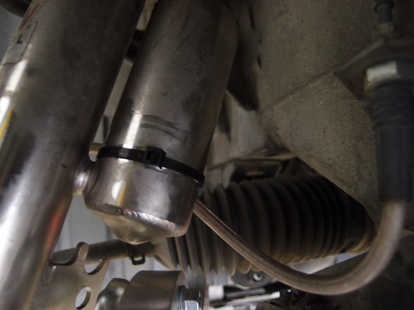

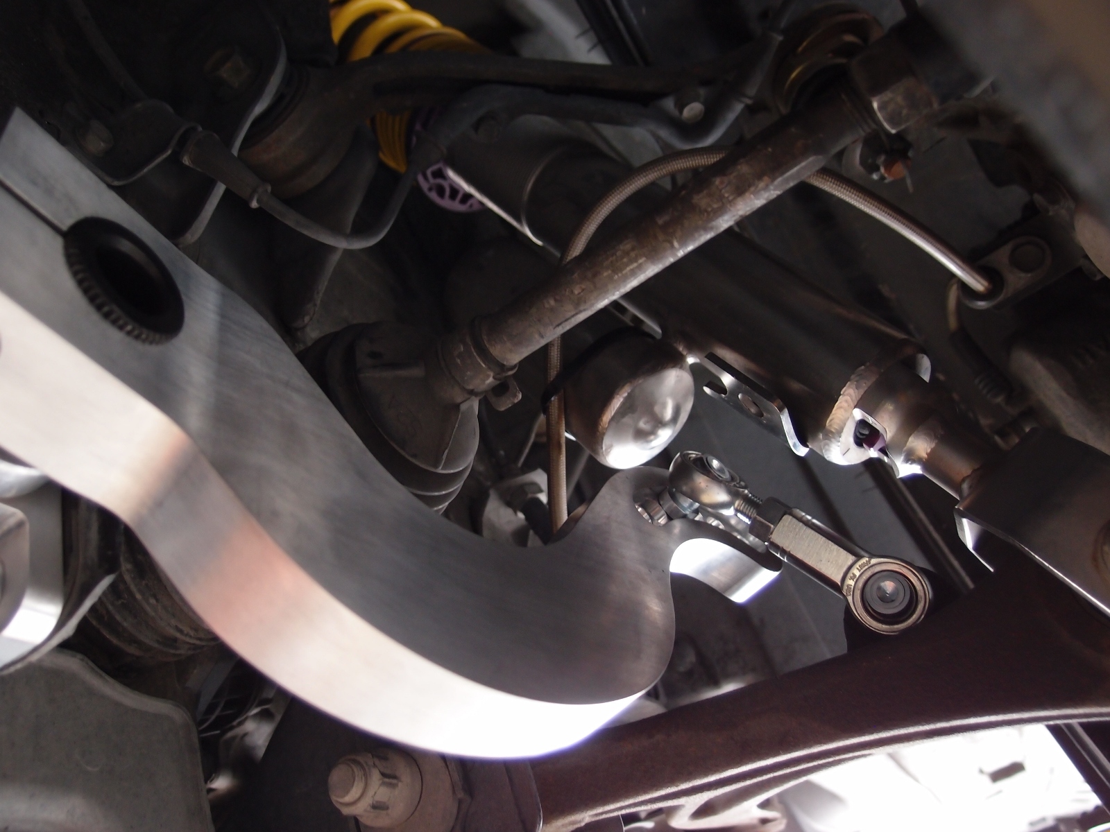

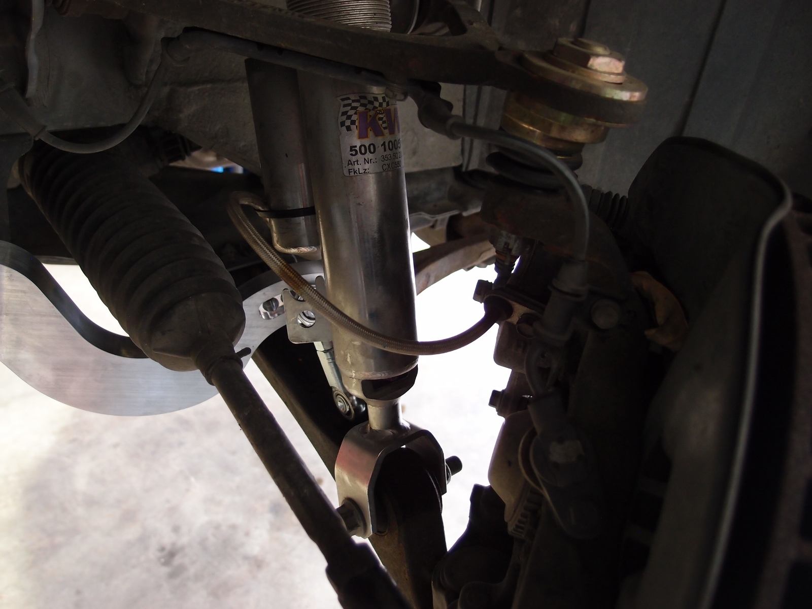

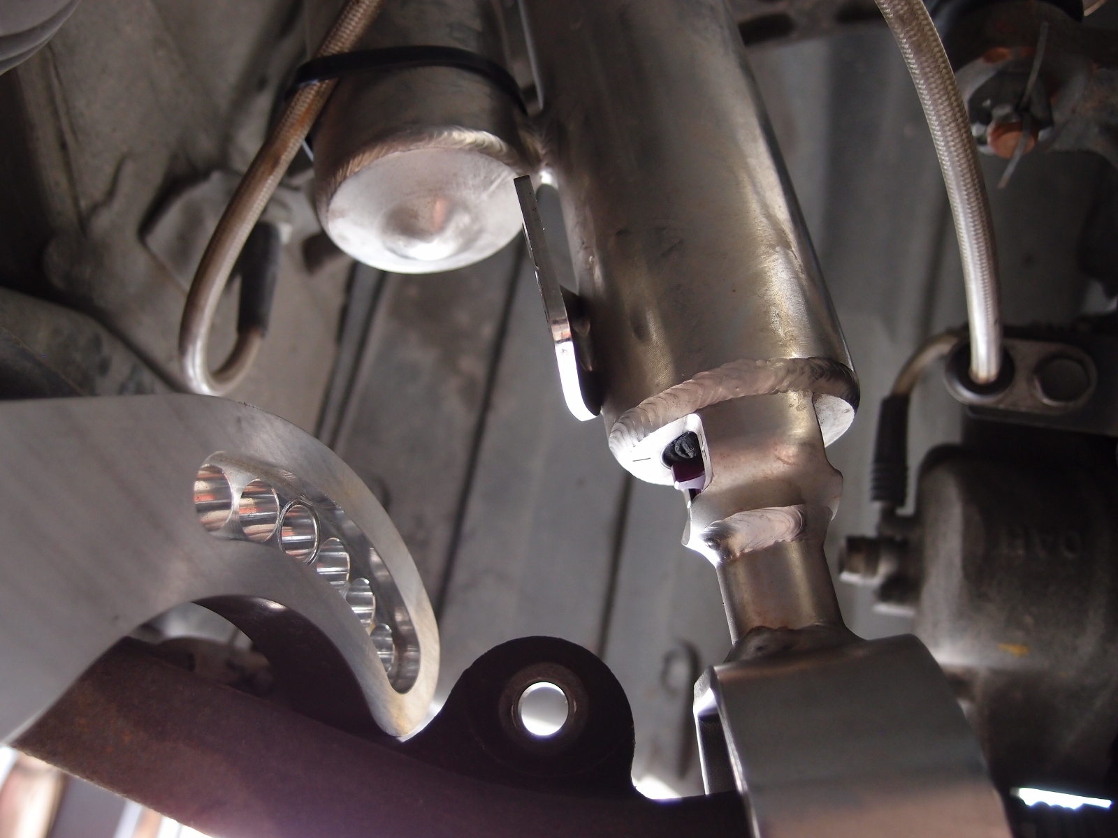

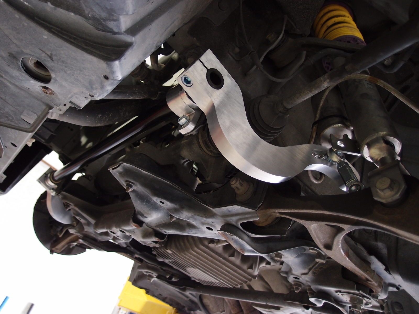

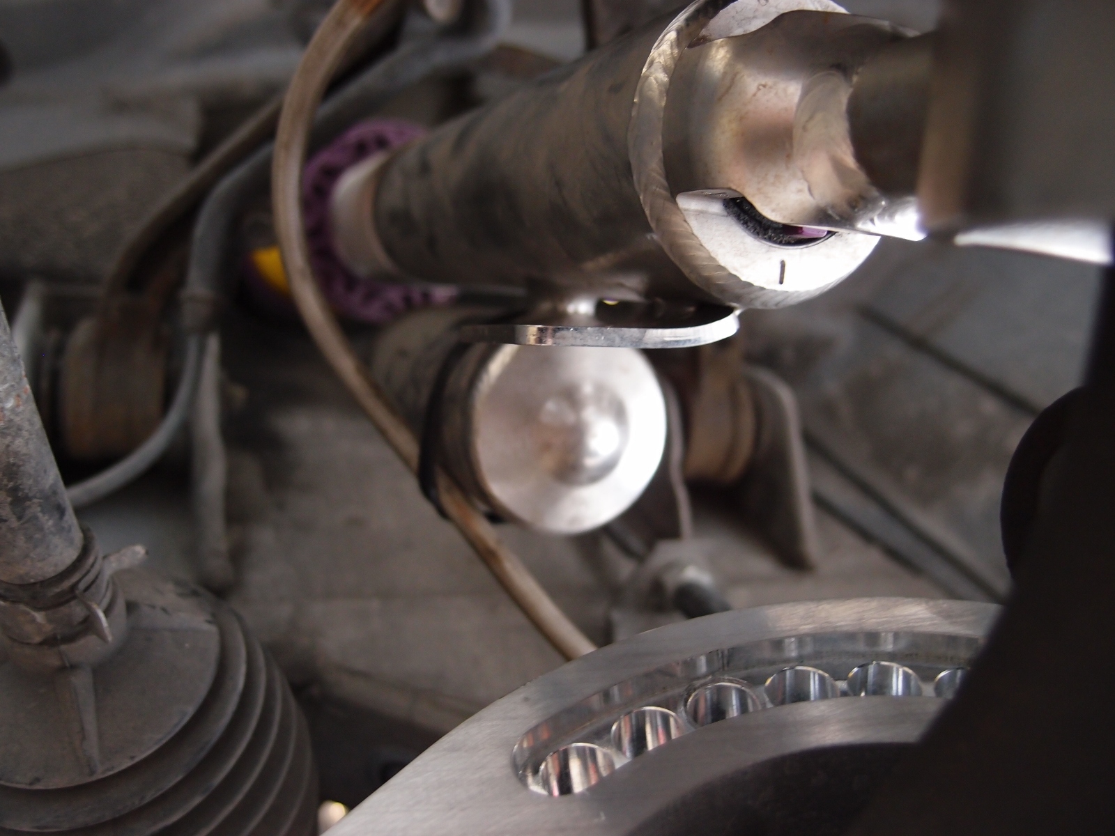

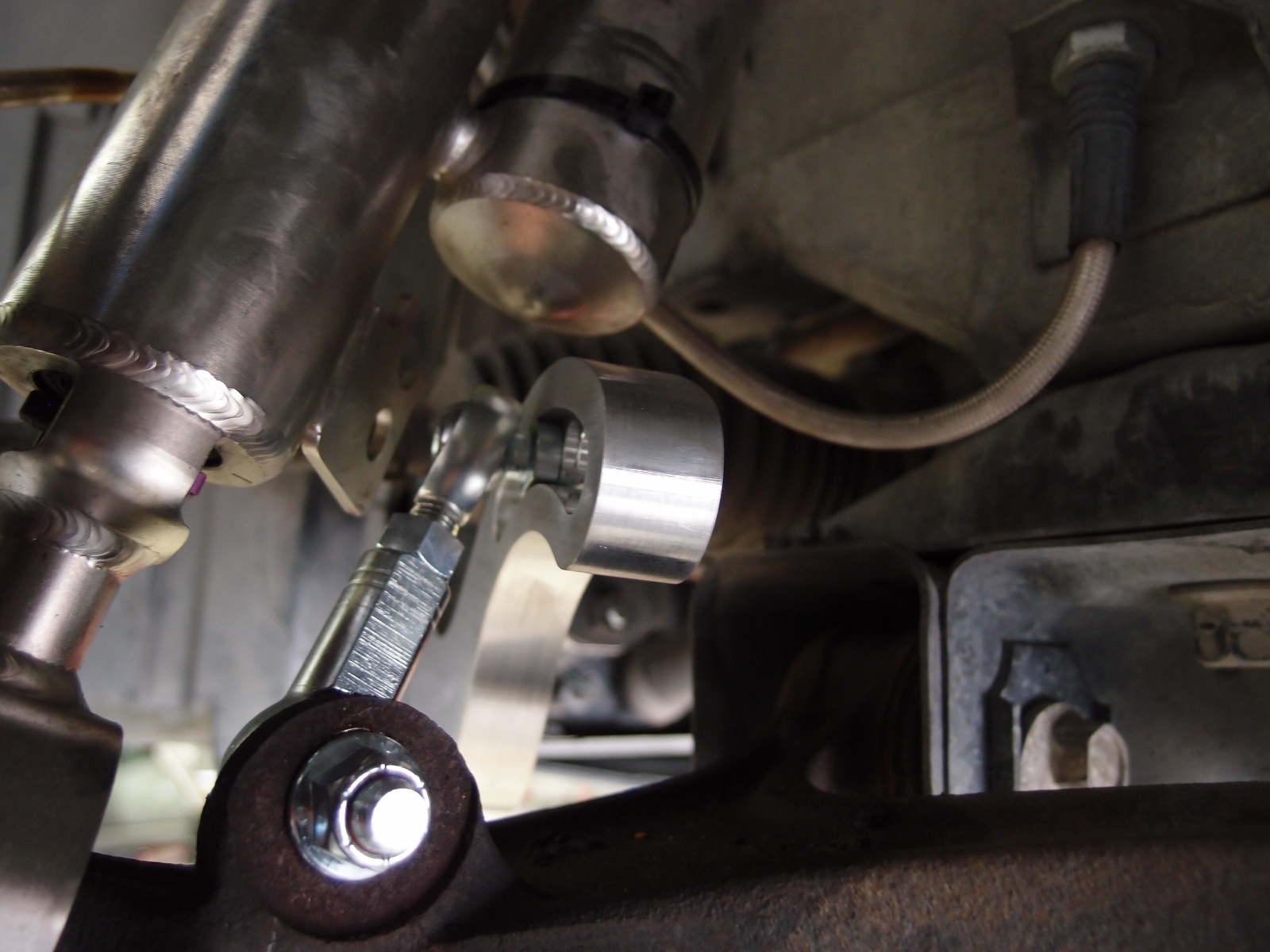

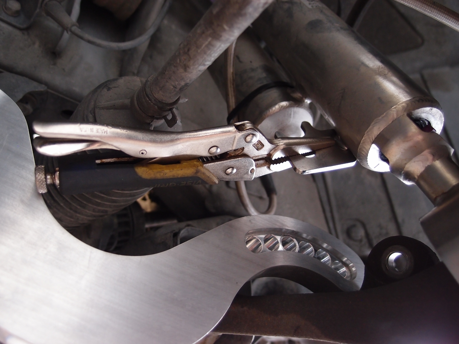

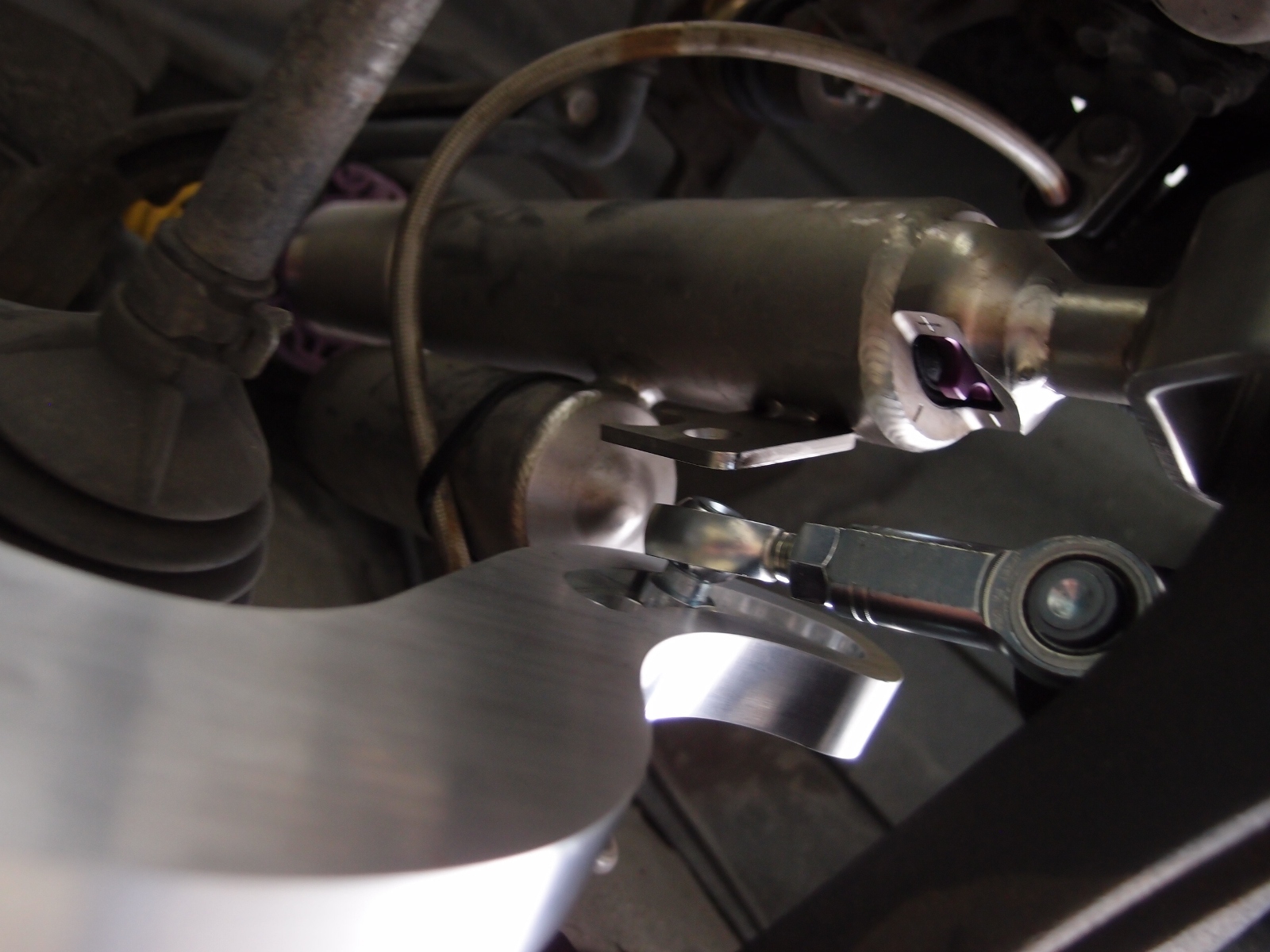

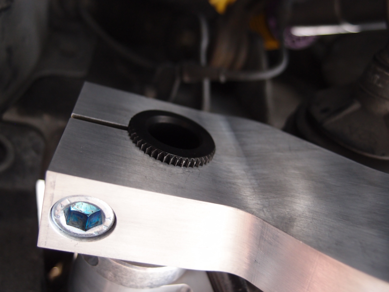

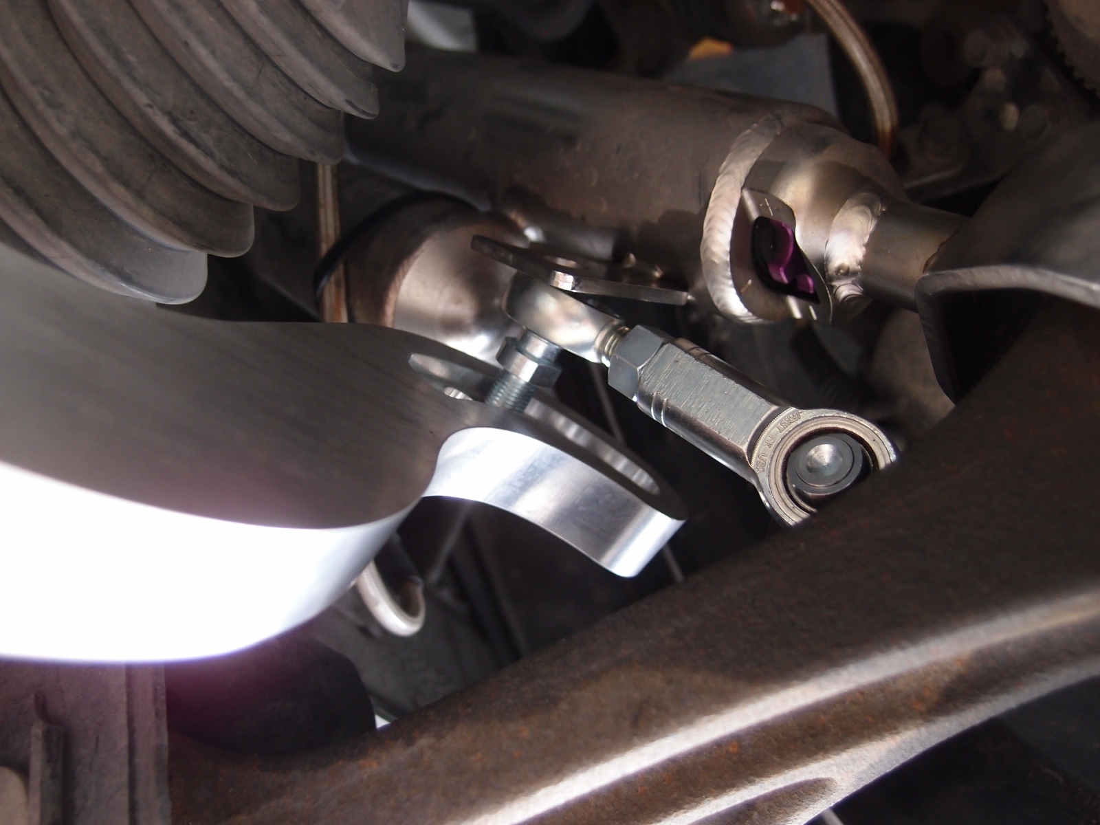

Kiwi, we should have posted this a long time ago. Just bend the brackets and push in the arms further on the center section than the recommended 1/16" position, and you can make use of our quick adjustment on the KWv3s, see images below:
