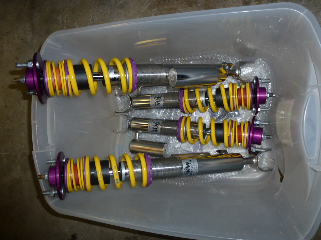

It really isn't that big of a difference. Maybe if the upper perch was more flat and less dome shaped there would be a little more room to suck it up closer. That's about the only way I see it making much difference.
The KW tops have a very flat top. The actual top with the bearing looks very very similar to the AST but the spring perch is a lot different and lot more compact. Too bad they are ridiculously expensive. I was kind of hoping I could source some kind of super flat upper perch like that and make them work with the GC tops having the lower boss milled all the way down.
I might actually try to use the GC tops without using an upper perch and doing it more like how the OEM tops are. There would still be room to mill the boss down a bit but I think I'd have to find a way to keep the spring centered. I'd pretty much have to make a top hat hubcentric ring
I do now understand the whole block height thing about the bumpstops and it certainly makes a lot of sense to me. I will say the stops that are from GC are much softer than anything else I've felt. I feel like I can squish them down to half the height just by hand. I can't get that close with any other stop I've felt. With that said they probably have a taller block height than I think they do.
