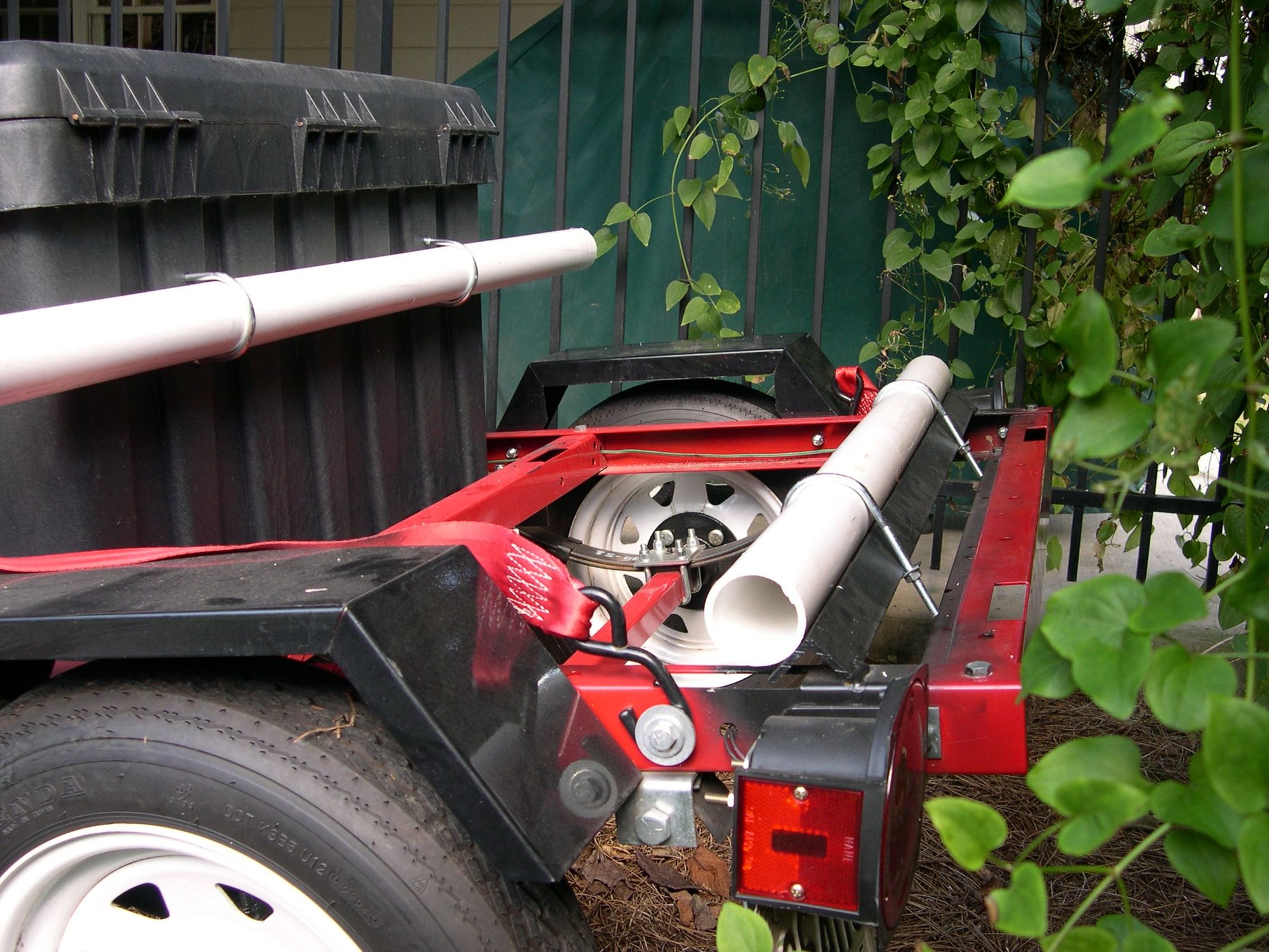

Just had to adapt a tire trailer for V710 225's and 265's.
Used 2" pvc and U bolts. ( <$15 )
The pvc on box is optional, I added it to keep it off the hinges as I noticed some indenting of the tires from the sharp edges on box. It's also been left longer than needed as I am thinking of strapping the pump sprayer externally to save room in the box.
the bottom pvc is u-bolted to an existing angle iron that was welded previously to hold some victoracers.(225/245)

Just a word of caution about planning to have the tires protrude a bit below the plane of the trailer top. Both my Toyo RA-1s (255/40-17 rear; 235/45-17 front) and my V710s (275/40-17 rear; 245/45-17 front) extend beyond the outer frame rails when placed side-by-side. So I bolted a plywood base onto the trailer, and I built a simple cradle for the tires above the plywood. I strap the tires on the bottom (to the trailer) and the top (so they don't splay), and also strap fore-and-aft. They don't move.

On test fitting, the V710 265's and 225's fit with room to spare.
these pvc tubes allow the tires to sit above the plane of the trailer top, so they essentially are able to use the entire space between the fenders.
When I strapped them down, it all seemed pretty solid.
But, would still like to see photos of your solution in case this doesn't work out.
