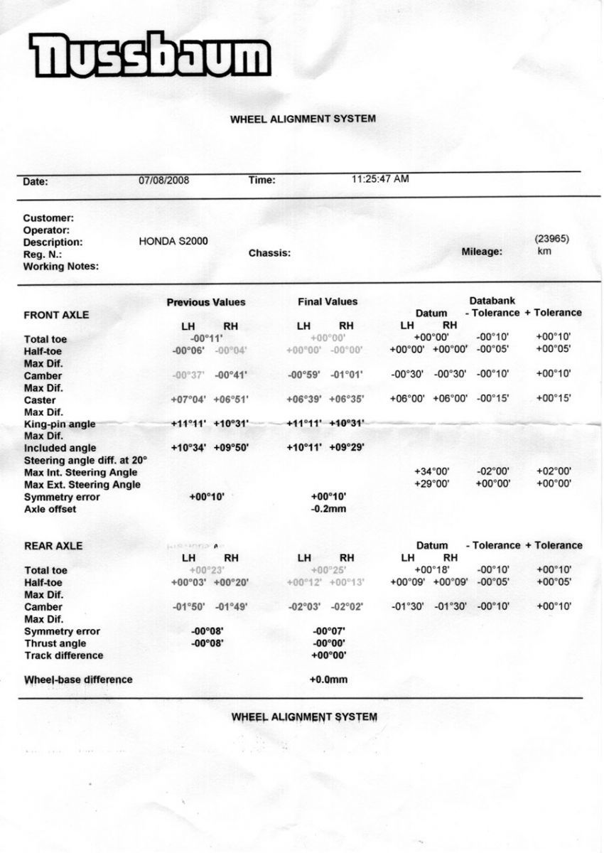

These are the reults of my last alignment, they are basically UK alignment with some added camber:

Issue number 1 is due to brake bias and general setup of the car (alignment, tires, etc.). But as long as it stays under control it's not necessarily much of a problem.
Issue number two is similar -- you will quickly find the "UK alignment" is much too tame for hard track use. But also you will find that understeer suddenly shifting to oversteer is a basic characteristic of the car, and has been all along.

On my old car with uk alignment it would it push at the limit then let got at the back in a scary way. Most people here recomend to max camber front and rear. 0.20" toe in each side at the rear and 0 toe in front then max out caster after thats all set.
My 03 with this alignment is much less scary
I would go for that don't worry about tire wear - I used to chew up the outside edge of tires before the car was alinged because I hadn't enough camber now its more even

Thanks for the input guys. I noticed between sessions that the outside edges of the tires, particularily the front have the most wear. Something I forgot to mention since they are not very common in the US, the tires are what you call R compound. I think I'll have a go at increasing the camber and rear toe. What effect would increasing front toe-in have?

More tire wear, among other things. Fronts should have zero toe. Rears should have as little toe in as you can get away with.

Camber and caster on the front are related in that the more caster you give it the less camber you can give it. So you want to get your camber up around 2.25 and then max your caster from there. With the stock suspension and swaybars you will really need to max the camber in order to get the tire to contact the ground in the corners.
You are right that all things equal a heavier front swaybar will cause the car to push more. But it's not always that simple. A heavier swaybar also limits camber changes, so if you can make it so your car doesn't roll over on the outside tire, you will get less understeer, not more. One of the big limitations of the S2000 is the lack of front camber adjustability. It's hard to get much over 2 degrees in my experience, especially as you dial up the caster. So a bigger front sway may help you.
The best solution is to change the tire stagger since that is where everything starts. 225/245, 235/255, 245/255 or 255/255 depending on what wheels you have. Since you have MF-10s I doubt you want to change wheels. I don't know what size your fronts are, but if they are 7.5" you could run 235/255, although a 235 tire on a 7.5" rim is a bit at the edge and you lose some of the feel of the tire. It probably doesn't sound appealing but 225/245 maybe your best bet.

Thanks, at my next alignment I'll make it a point to max camber then work my way from there regarding alignment. I don't use the car much on the road anymore so I'm not too concerned about wear or comfort.
