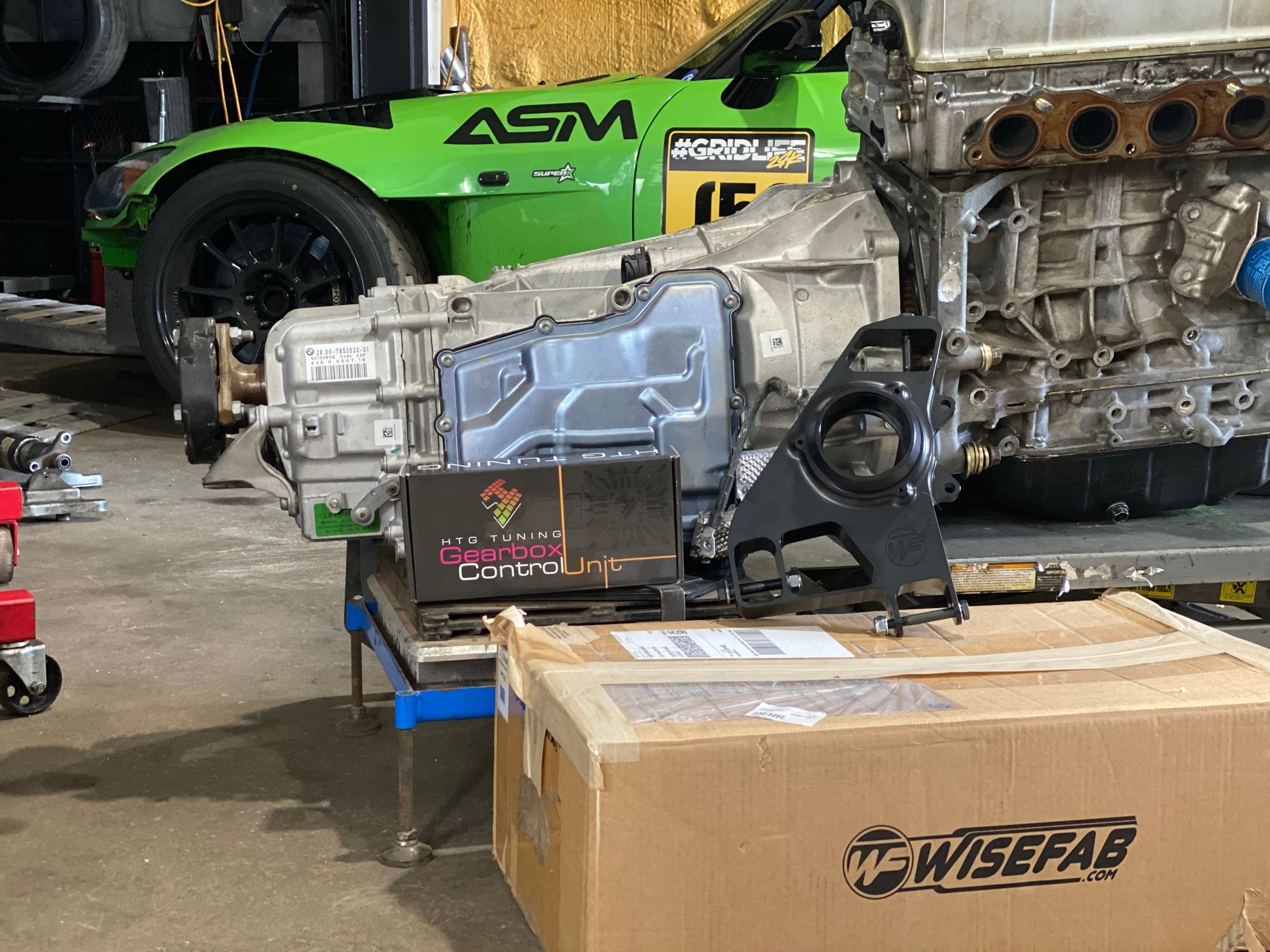

I saw that the third party DCT controller stuff is floating around now, curious to see how well it fits into the tunnel.
we have a hammer, a big hammer, a grinder, a cut off wheel, and a welder. It’s going in there.

I saw that it fits into the Miata tunnel, but I hadn't compared the sizes of our tunnels
yes, and put out exhaust out the fender so we don’t have that in the way.

Awesome stuff for both cars. Will be a really neat proof of concept. I saw that post on the miata and read through a bit of it. It mentioned modified transmission tunnel. Look at the left side tunnel of the picture and you can see some weld marks. Would be great if the S2k trans tunnel does not need modification but I would be surprised if it does not.
