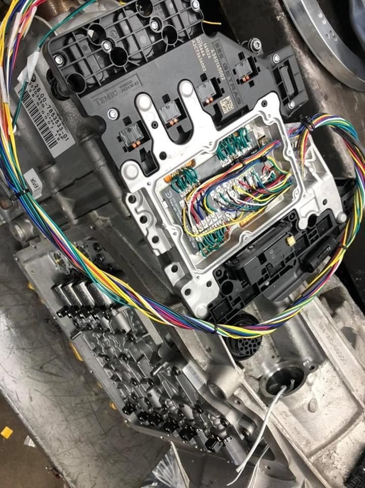

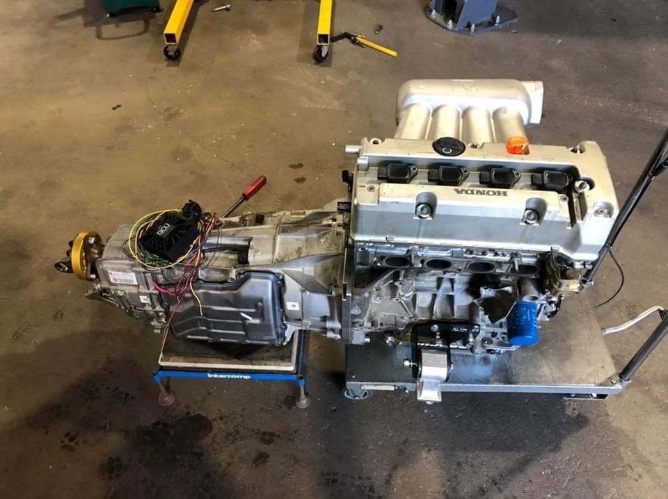

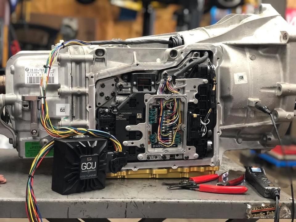

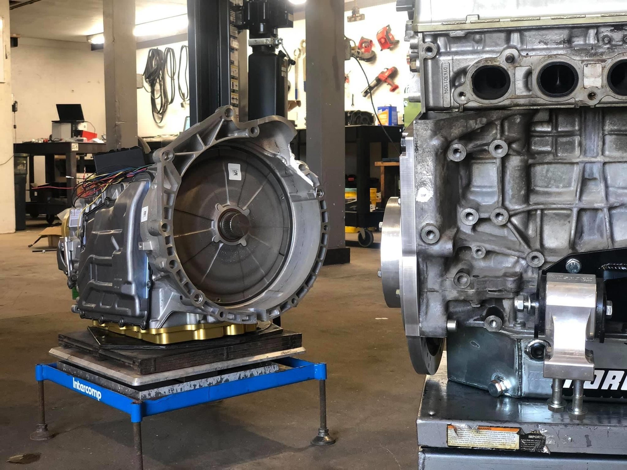

ASM made good progress today. Feels like we are so close but still so far to go. Engine and trans are ready to go into the car.
Mechatronics all wired up and installed back in the trans.
Trans and engine all done and ready to be bolted together
Ready for the car
Road America is next weekend and we very likely won’t be ready with this new setup, still too much to do. Hoping to get this tested and then first competition event at Gingerman in Oct. If it rains I will legit cry.
