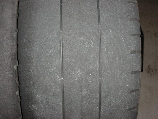

I am not real experienced with track tire life (ditched my previous A032

You might get through an autocross with those but not a whole weekend track event.

Damn, I was afraid you might say that! So you are telling me that there is not much left to a Kumho once the grooves are gone? ~200 laps at TWS is it? This is going to be more expensive than I thought!

It all depends on if you want to drive home with cords showing. If you had street tires along also, I would say go for it.

I can't tell from the picture exactly how worn that tire is but you still have some life on Kumhos after the little grooves are gone. Once the main two grooves are gone the tires are shot. I know I could not make it through a whole weekend on pretty worn Kumhos.
On my Prelude the right front always wears the fastest at TWS. On the S2000 the right rear will always wear the fastest there. Now on the Prelude I have it easier than the S2000 because I can rotate the worn fronts to the rear and they will still last a while. I also carry two sets of tires per event. That way I can take a set that is almost gone, finish them off, and move on to the new ones. Don't you also drive your Kumhos to and from the track? If so I would be worried that you might cord one and drive on it 200 miles back to Dallas

Here's the photo of the tires that I DID use at one more track event (the photo is from before the event). They worked fine, and my guess is that there is still an autocross or two left in them, but I had street tires to drive home on. HTH
