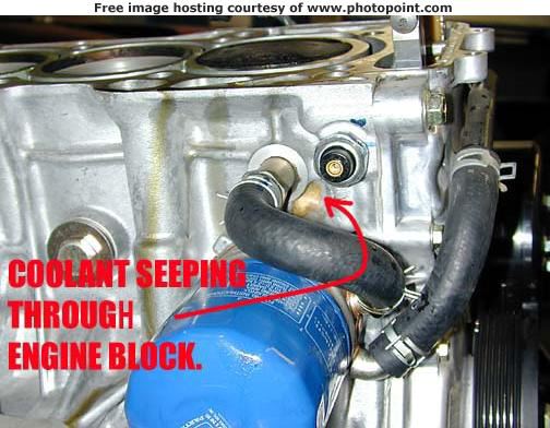

If anybody else has had this problem please speak up.
Aaron, if you have those photos could youplease post them here.
I know another Sydneyite, JD, had this problem and had it fixed at the same dealer.
I'll point the dealers to this thread so they can see the history.

Did a bit of a search and found mention of AaronS2k's porous block and pictures:
Apparently they gave him a new short block (are you listening Honda Australia?).
[Edited by AusS2000 on 01-15-2001 at 09:57 PM]

Hello all,
Just responding to the thread above.
I have had a new short-block installed by Damelian Honda in Sydney (with close involvement of Honda Australia who provided several senior technicians).
The engine component of the job involved replacement of everything below the heads with a new short-block that comes from Tochigi. The heads and valvetrain are retained from the old engine.
The engine component of the work takes about 4-5 working days and running-in is a good idea afterwards.
Mine has worked well since it's repair to the credit of all at Damelian and Honda Australia. Yours will be the third S2000 engine they have rebuilt this way so you will not be the first!

Sorry it took me so long to chime in. For those who would like to see all of the pictures go to:
http://albums.photopoint.com/j/AlbumIndex?...19900&a=7533788

It's confirmed.
A new short engine is on it's way from Honda.
