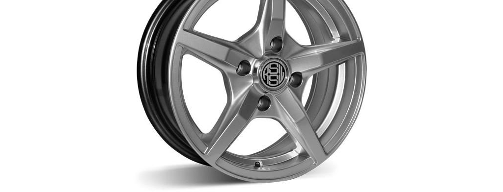

The Enkei F3 rims look decent, not quite as nice as the ap1's but at least they come in a 17 inch size. When searching for rims for my track car I found a very similar looking wheel as the USDM ap1's but they are only available in 14 inch sizing, 4x100 too lol. Maybe okay for an 80's Honda but not an S2000 lol. So close though.
