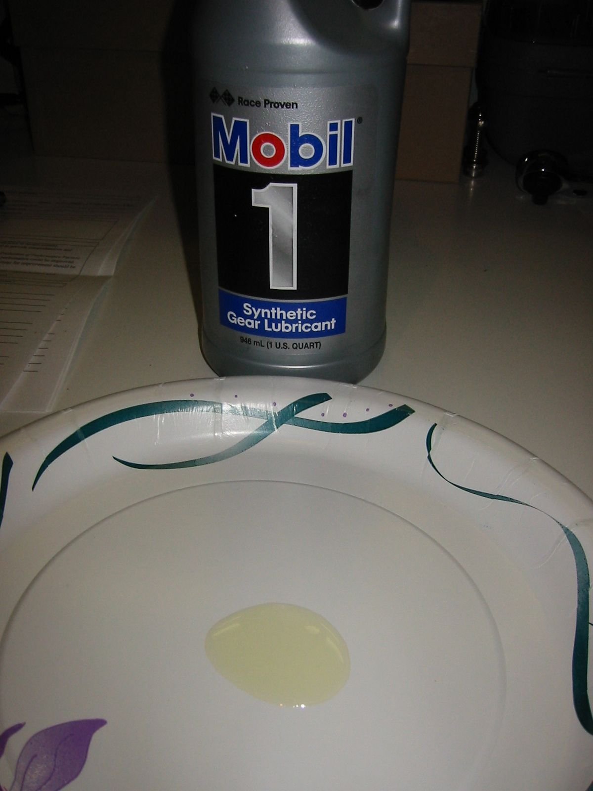

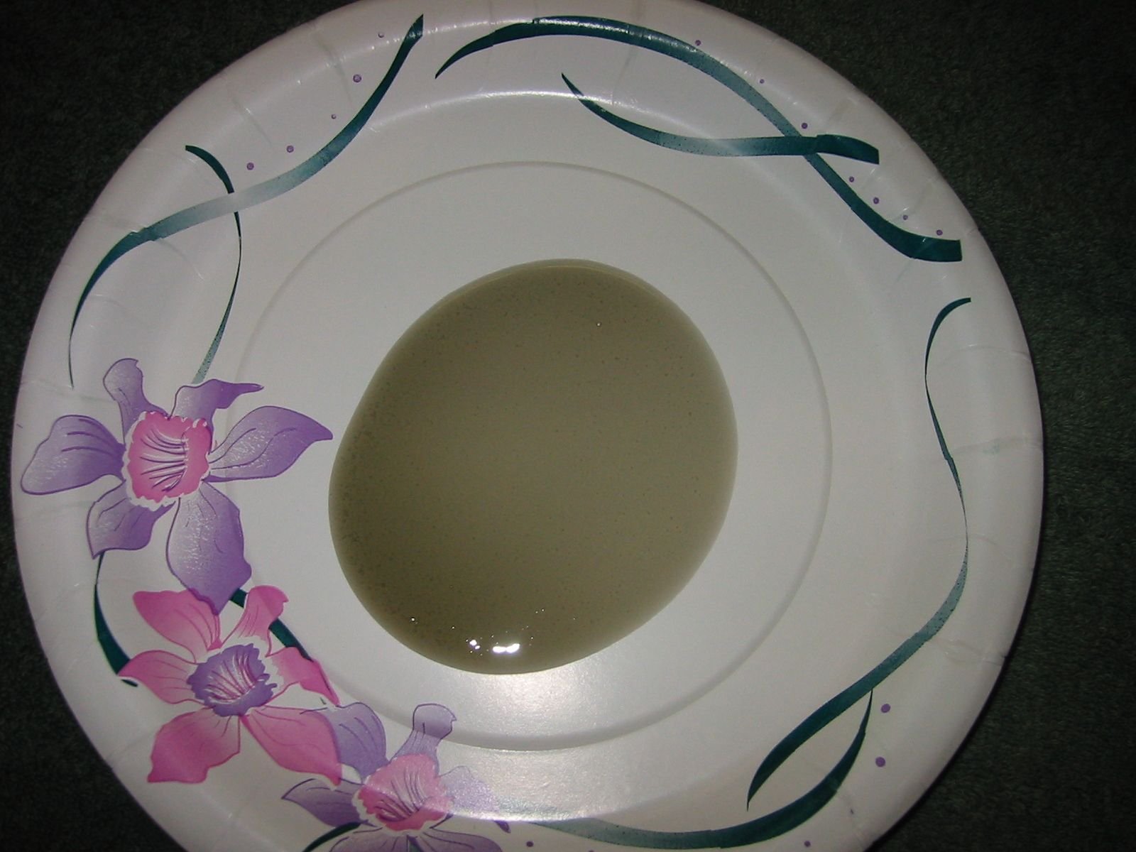

As stated above, I was not pleased with the buzzing noise and was in search for a solution. In the process I found out that regular dyno. oil was put in the diff. for the new gears. As recommended by xviper, I decided to swap out the diff. oil to synthetic @ 600 miles.
I used Mobil1 GL-5 75W90 Synthetic Gear Oil.
Brand new Mobil1 Synthetic oil
Dyno. oil after 600 miles. No metal shavings detected, which is a very good sign!!
Mobil1 Synthetic gear oil after 900 miles. Also no signs of metal shavings. At this point I knew for sure that the installation was very good and problem free.
As you can see in the pictures the oil in your rear diff. takes a beating like no other. Just after 600 miles the dyno. oil was very dark and thick. The synthetic stuff really held up and actually still maintains the clearness and honey like consistancy. Using the synthetic oil reduced the buzzing sound but did not resolve it totally. I have gotten used to the sound and do not notice it as much as before.
