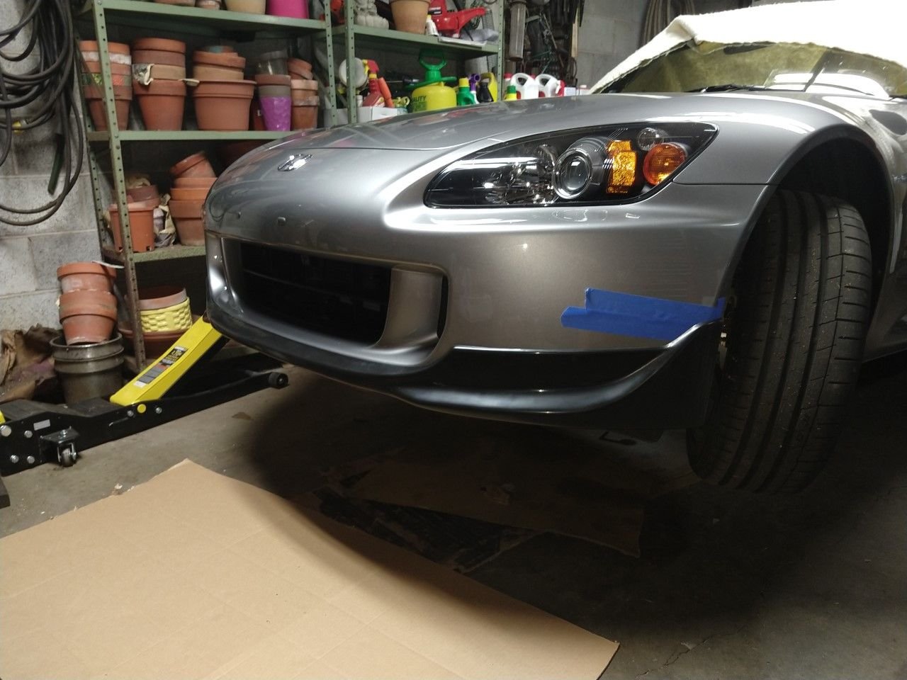

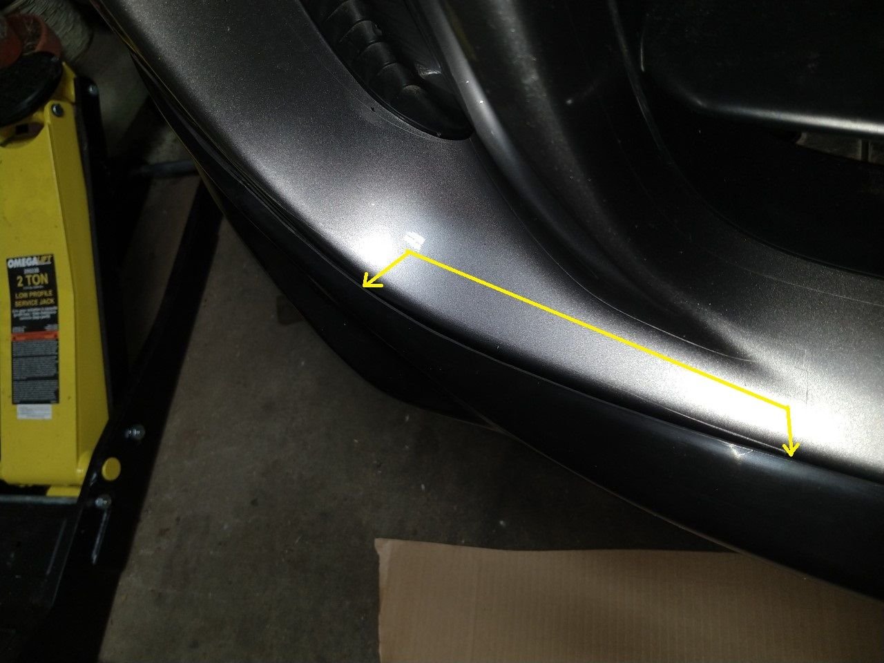

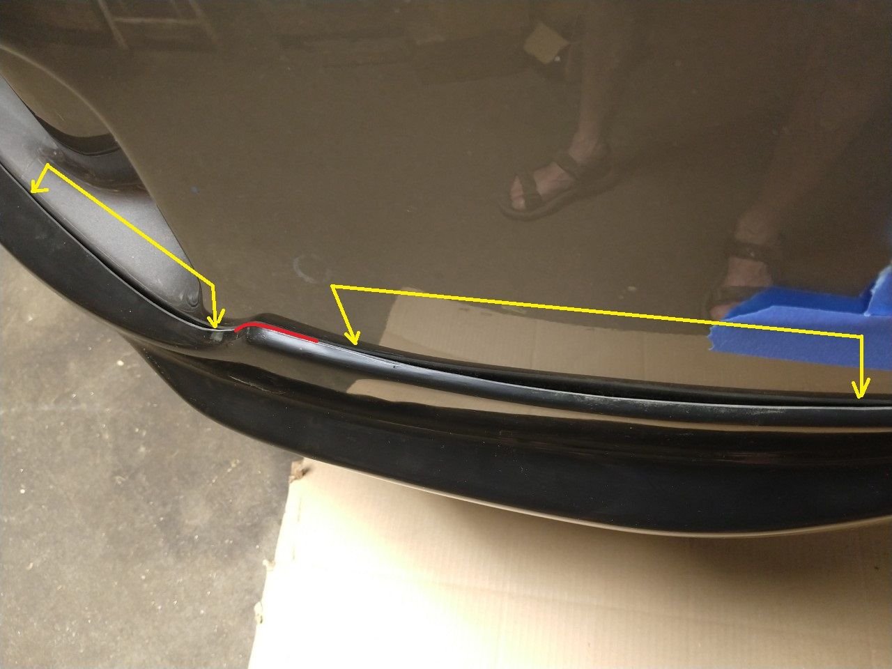

Trial fitting of the BasonR replica AP2 lip (showed up today, comes with hardware). The bottom push pins lined up well. The left side screws lined up well to the existing location. The right side lower hole lined up well. The Upper one took a little bit of pushing to get the hole to line up to the existing dimple. There are slight gaps which MIGHT not show with the weather strip added along the top edge. But I'm going to trim the left side about 1/6 of an inch. See picture, the red area just to relieve it a bit. I think that area is causing the slight gaps highlighted in yellow. For the right side I'll try a heat gun to help mold the part tot he fascia. On the back side of the lip is a thin area which I can add 3m double sided tape to help fit the lip.. This might work well enough w/o reshaping, but I'm going to reshape 1st.
note- sanding where pictured and a little heat seems to have done the trick...it fits with less of a gap now.
Be warned the pushpins for the bottom of the lip are brittle and if attempting to remove them expect they will break..In trail fitting the lip I tried to remove the pins only to break them, luckily I have extras.
Left side, highlighted yellow gap, red area to be trimmed 1/16" to help reshape
