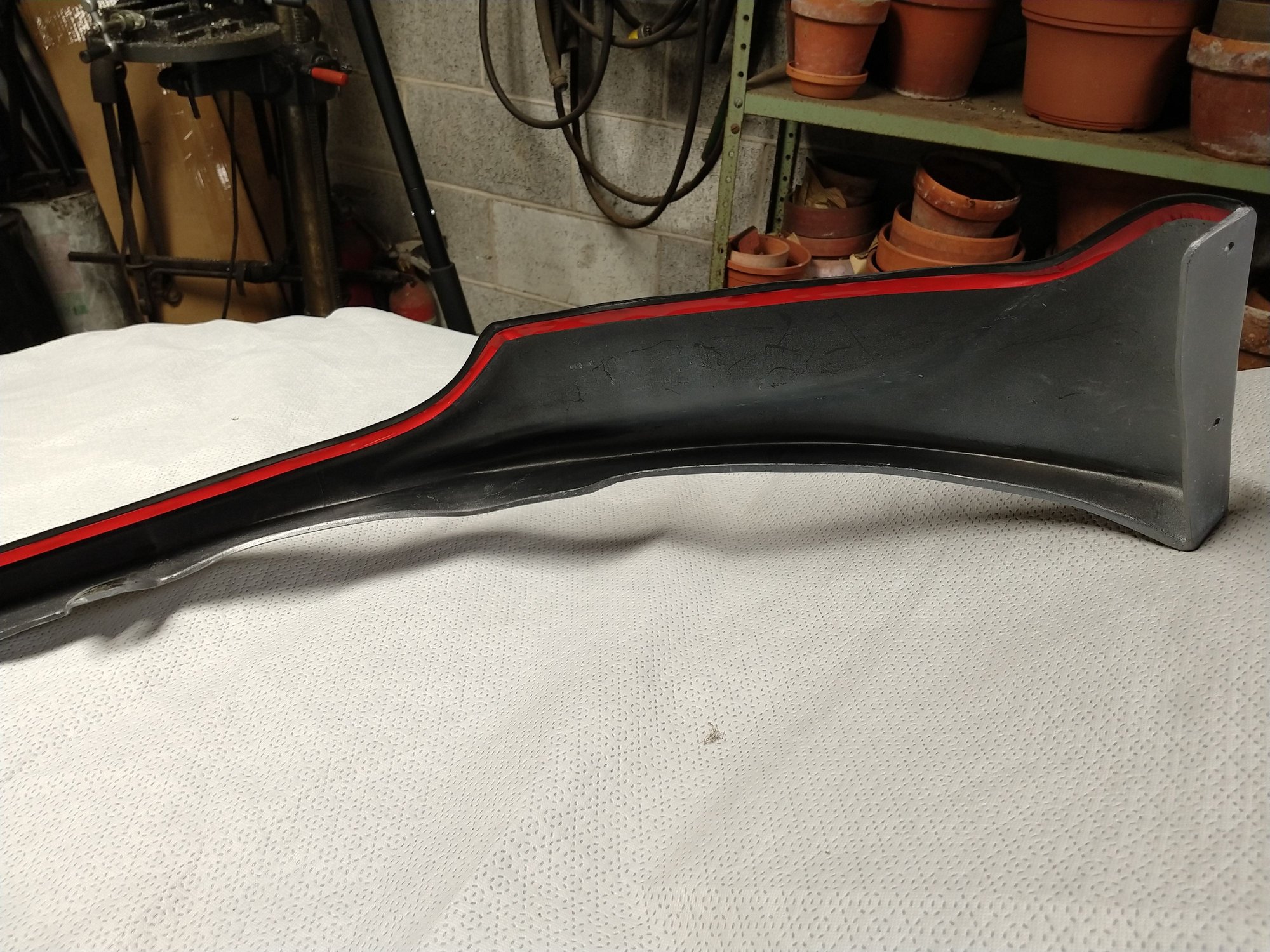

getting closer to installation...got the 3m double sided tape today...just put it on...the lip will go on tomorrow..and then I'll see how well the sliver I sprayed matches.....the thin rubber gasket will help hide any small differences in color.
Note- the double sided tape isn't strong enough to close the fitting gaps to the fascia...this is a clear 3m double sided tape...

Looking good!
Be sure to use same tape technique used for rear spoiler. Start with only the center exposed. Red protector pulled back enough to use as pull tabs. Hold in place, make sure fit properly. A helper would be ideal.
Then peel back from center, while checking piece is still in correct spot.
Then apply pressure to one section at a time. Hold for like 30 sec to ensure proper bond.
