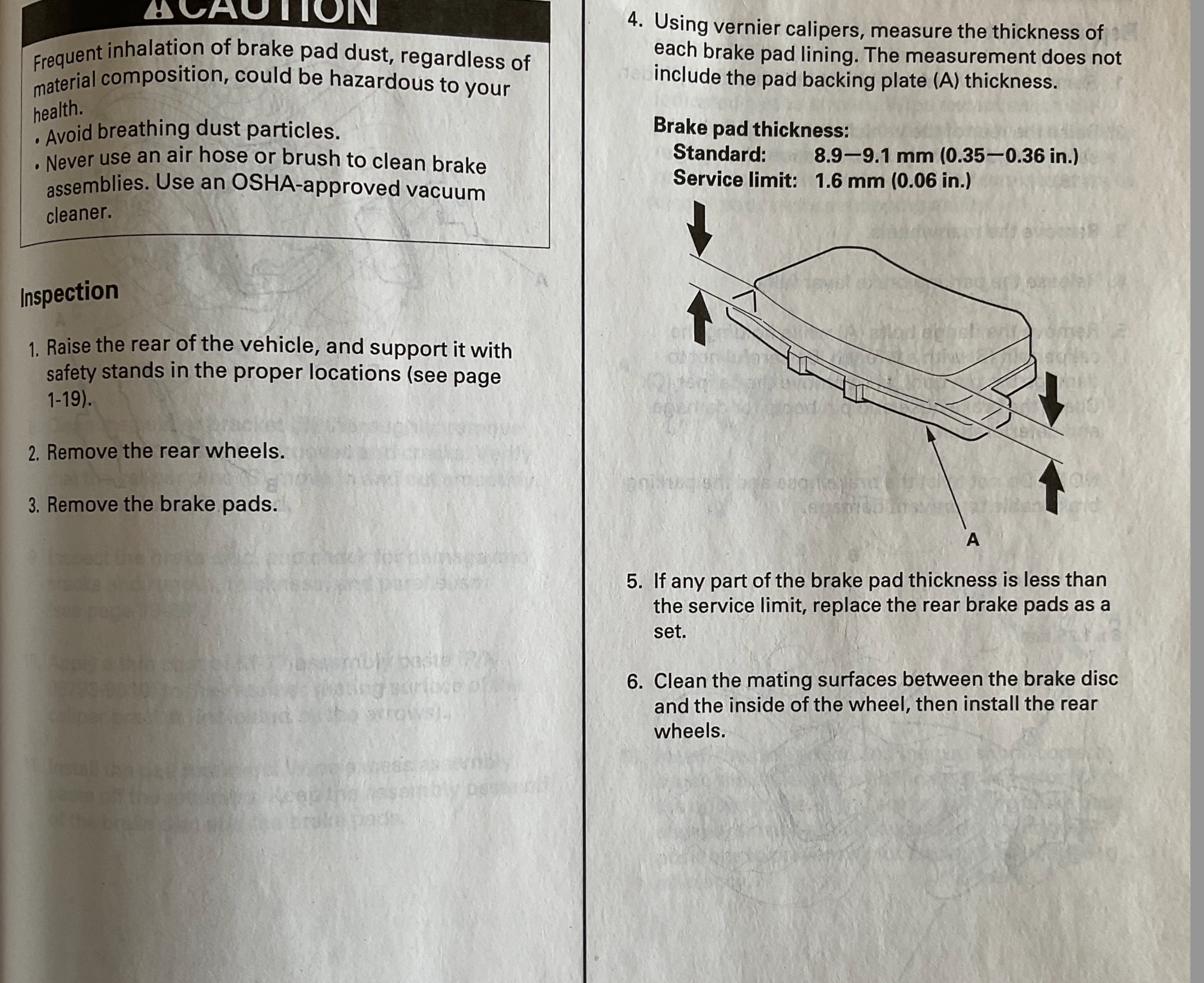

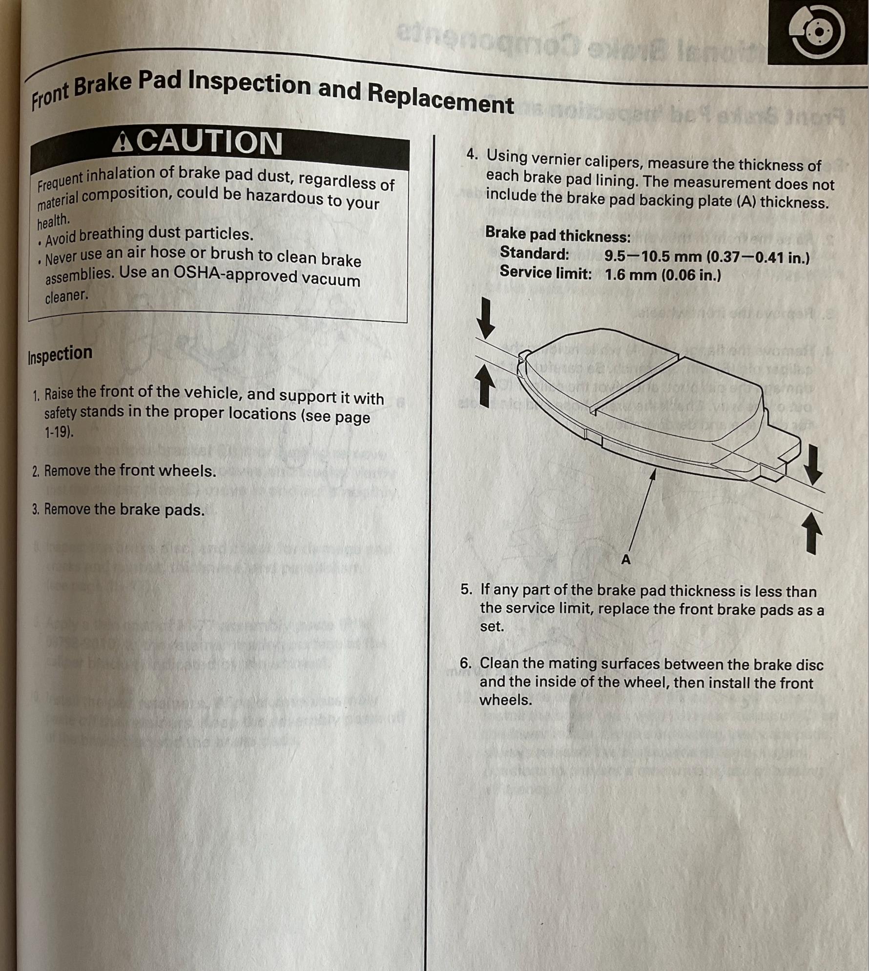

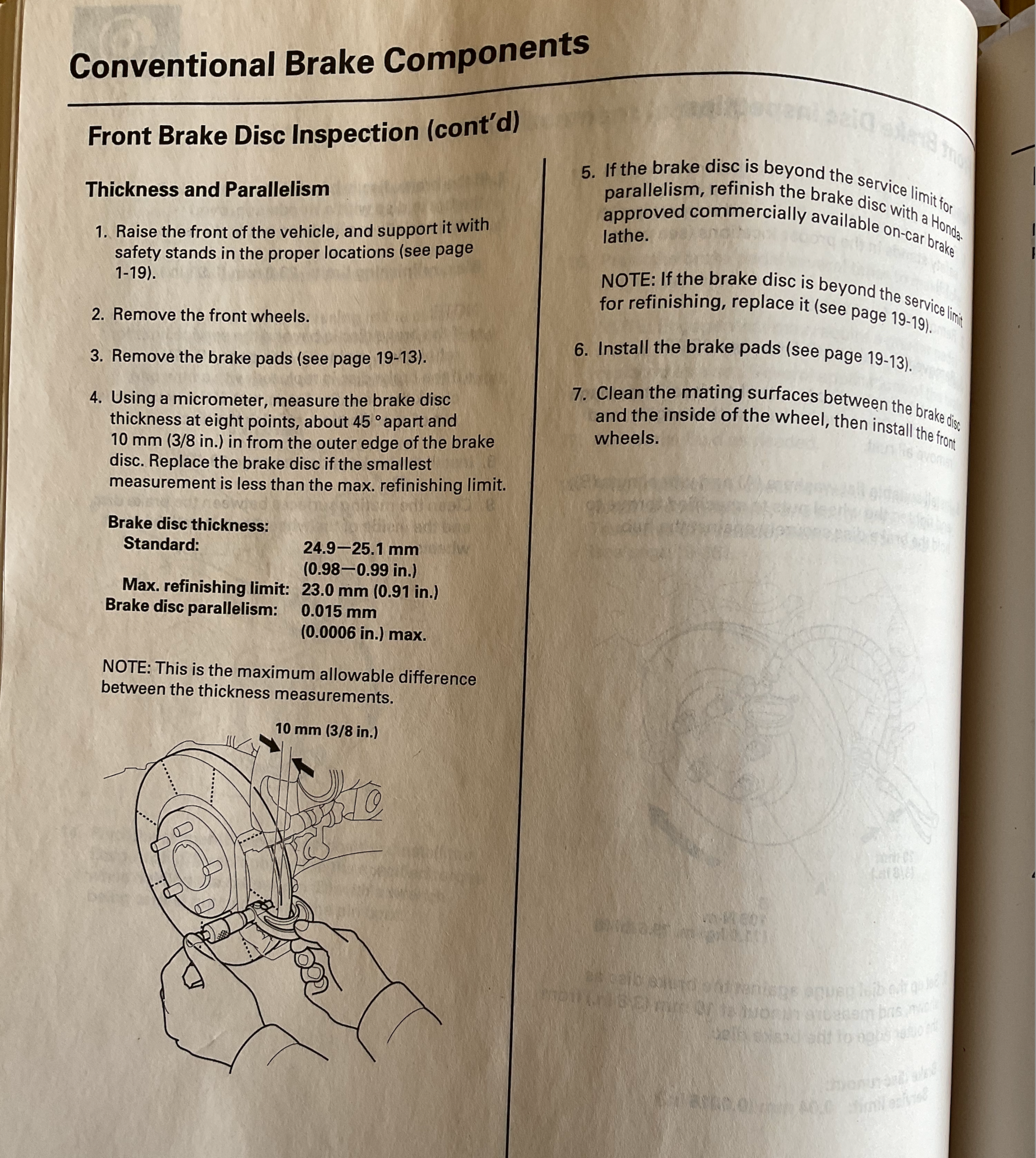

What are the minimum service thickness specs for the rear pads/rotors tho?
(I assume the fronts are 3mm for pads and 23mm for rotors)
Old Apr 18, 2022 | 09:33 AM
cosmomiller's Avatar
Top Answer: 1
Joined: Aug 2012
Posts: 7,887
Likes: 3,430

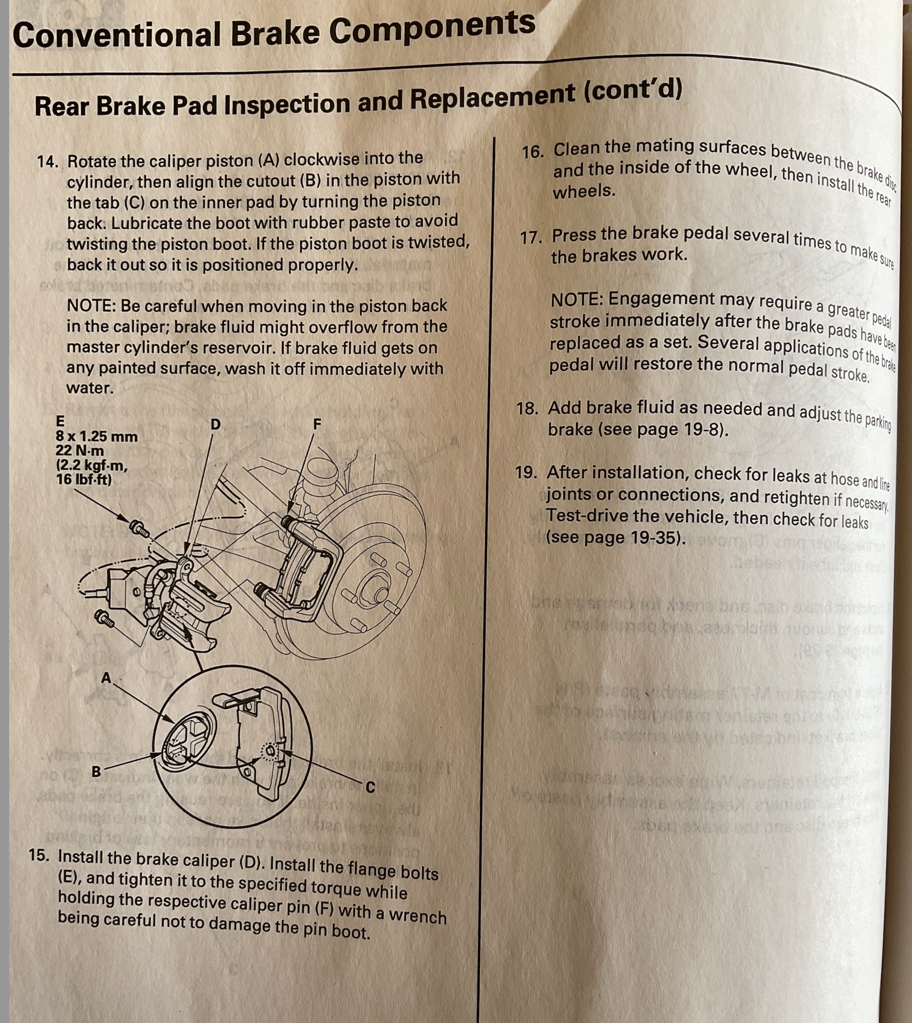

From the manual:

@cosmomiller
Even better with the torque specs! Nice one! Thx!
