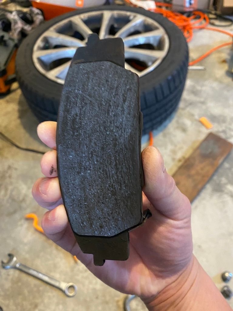

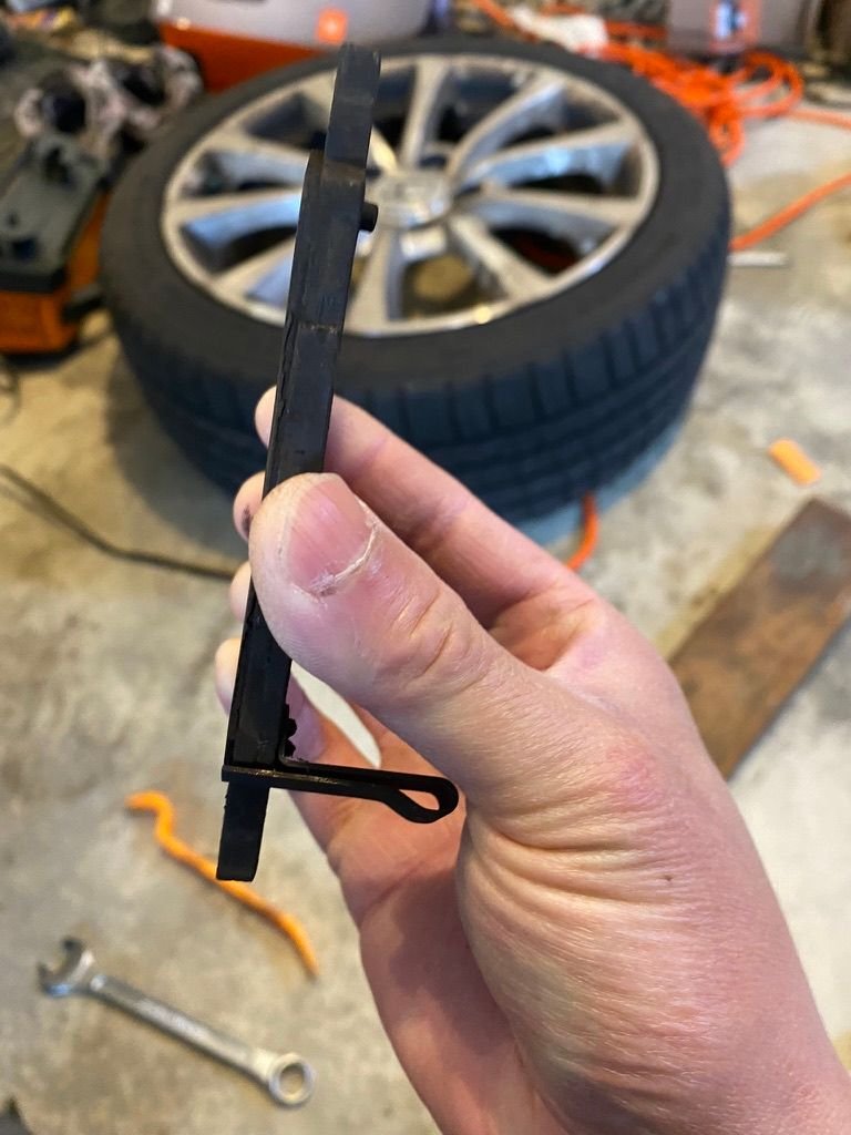

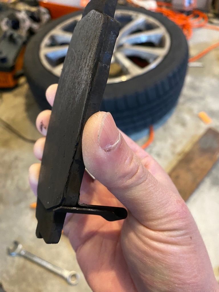

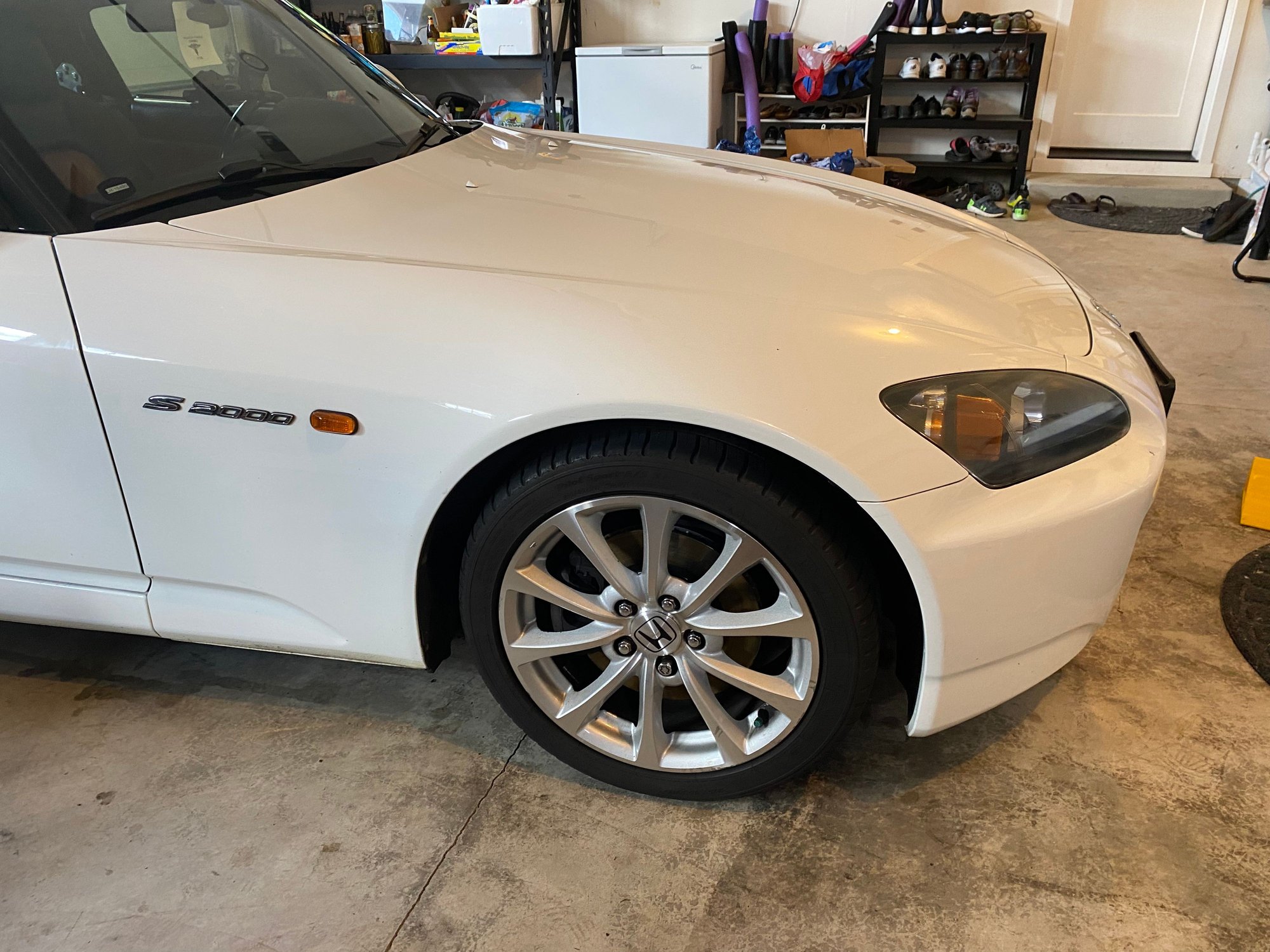

I am an original owner of a 2007 s2k and just replaced my front brakes diy at 65k miles. There was a high pitch squealing noise which indicated something was amiss. I do most my own maintenance on her. I was initially concerned since I read something about the bearings failing at some point on our cars. Watched some youtube videos, took her apart, and low and behold the pads were worn down to the warning indicator. When that happens, the metal indicator contacts the brake rotor, making that horrible metal on metal sound. Fyi I do spirited driving only, have not tracked or autocrossed the car. I was tired of the brake dust so I went with HPS hawk street pads and new OEM honda rotor. Those pads are supposed to throw less dust but will see after I finally wash her and see how long it takes for the wheels to get dirty.

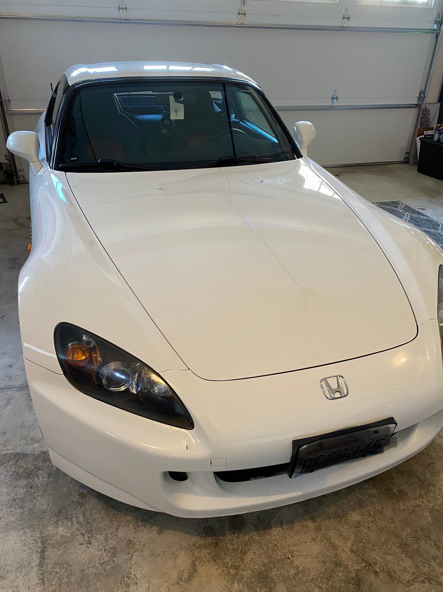

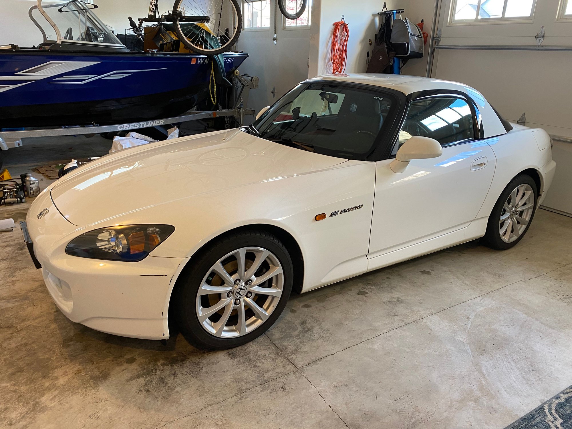

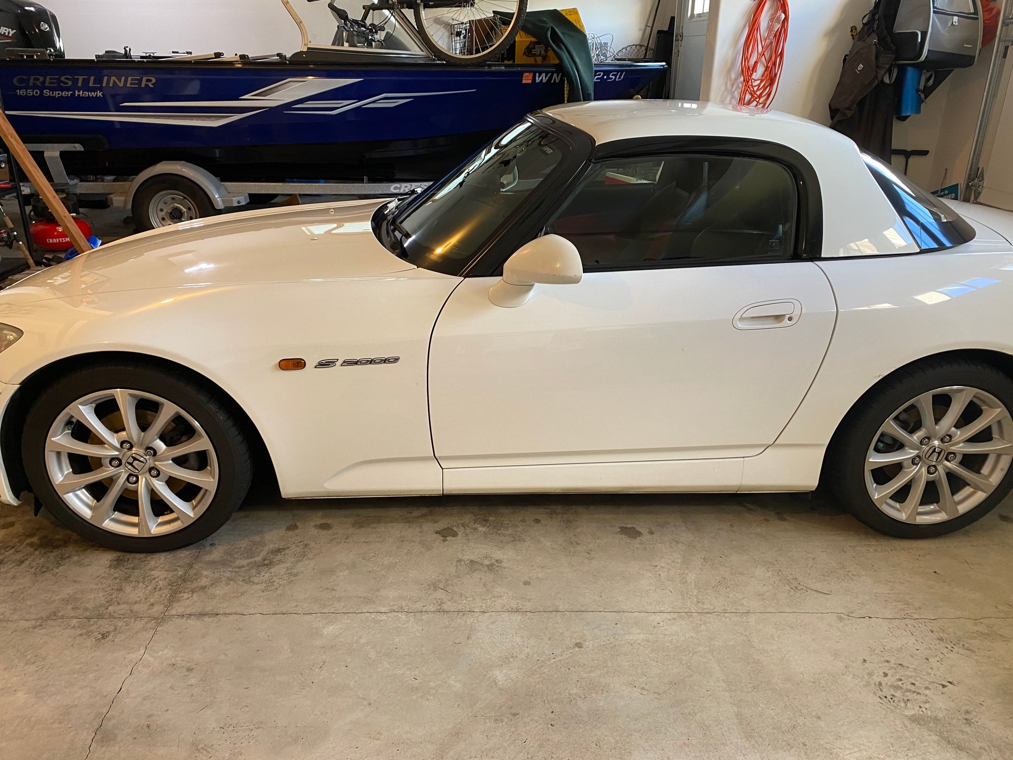

Don’t know if they are less dusty than oem yet. (Hawk HPS HP street pads)
Just washed her and will see how long it takes for wheels to get filthy.
I’d have to say, she still looks damn good after 15years
