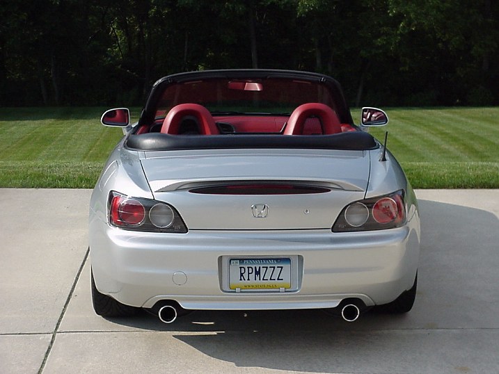

Cool.
You should also have them do your bottom valance. This sholdn't cost you much more and will look awesome when you get it back.
They will already have your bumper off so this will be easy.

^Hey, that looks sharp.
I'll have to aks how much extra that would be.
Thanks.

i actually prefer the bottom peice in black, but to each his own.
