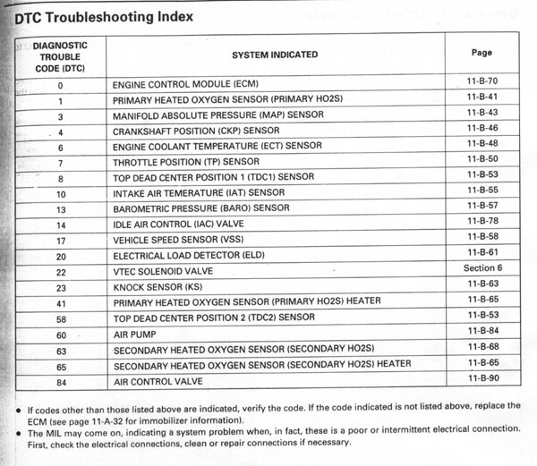

I just checked the workshop manual and if you put a wire across those connectors it will go into a diag sequence. I'll post the codes shortly.
Old Mar 22, 2001 | 09:53 PM
AusS2000's Avatar
Posts: 30,809
Likes: 15
From: Sydney
'ere 'tis:
Try this at your own risk!

Thanks for the sheet Aus2000
