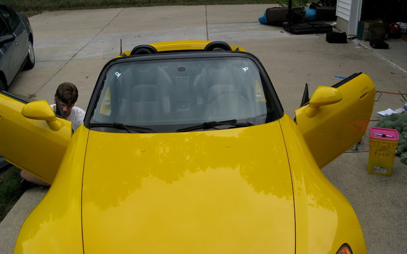

To fix it: swap them! That's it, so far it hasn't come back. Details so you know how long it takes:
1. Remove bolt holding the mechanism to the body.
2. Remove door card.
3. Remove speaker, the mechanism removes from inside.
4. Remove 2 bolts holding the mechanism to the body.
5. Repeat for the other side.

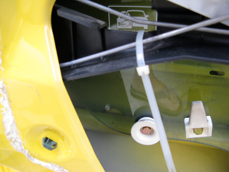

6. Reinstall passenger side on driver side.
7. Before you reinstall door cards: check the door for rattles. Hold the 2 plastic spacers for the interior door handles with one hand slam the door with the other hand.
Sources of rattles: the lock or latch arm.
The window retainer that has fuzzy stuff on it.

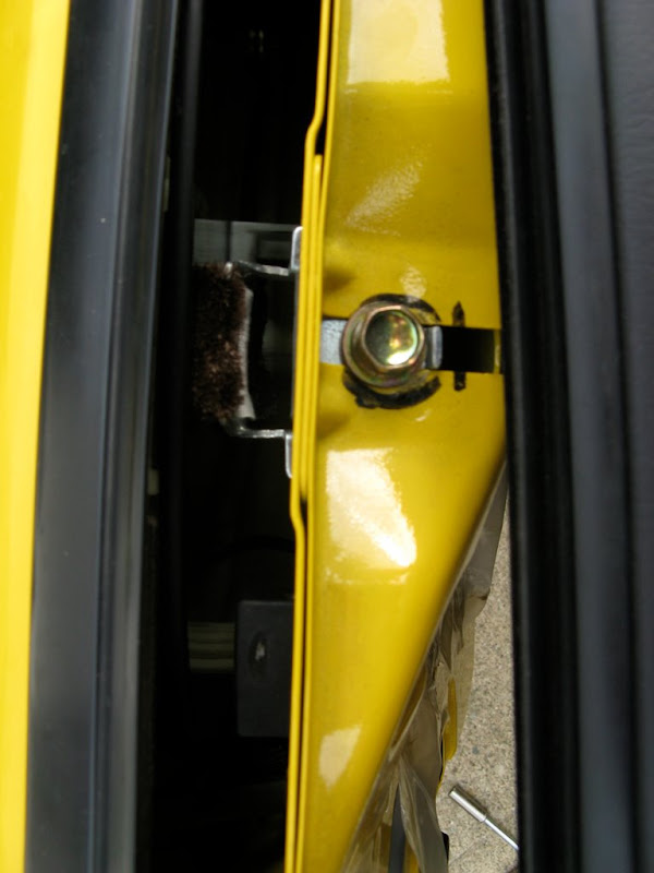

The key to adjusting the fuzzy window retainer: there is just enough room to brace the retainer with a flat screwdriver as you tighten the bolt. This keeps it from spinning. Be very careful.

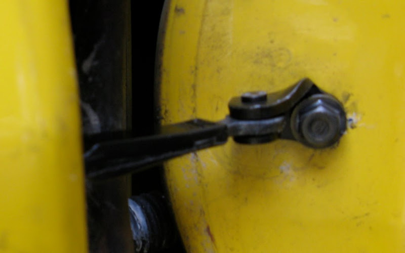

Another closeup of the mechanism. Note it is now upside down.
