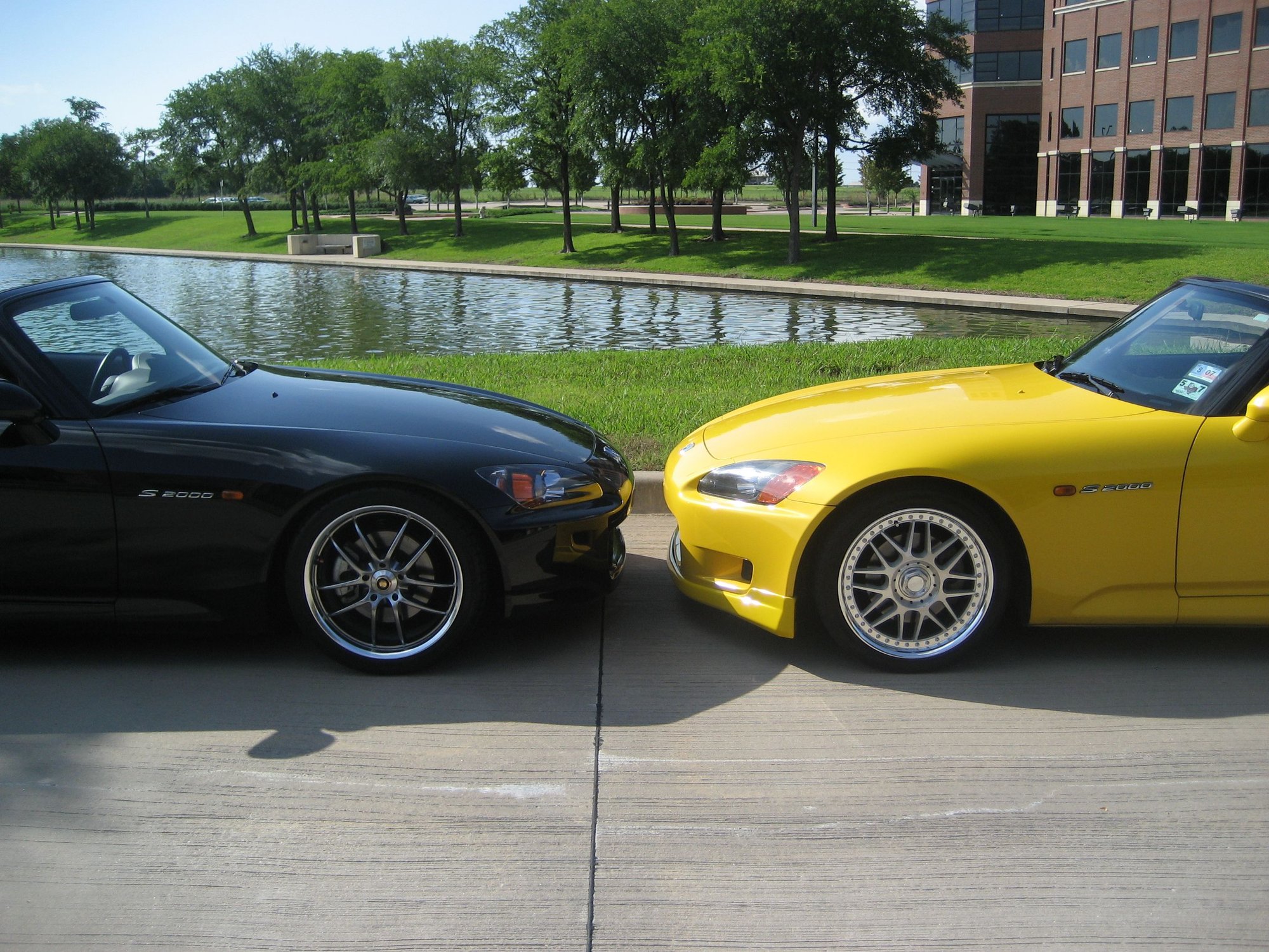

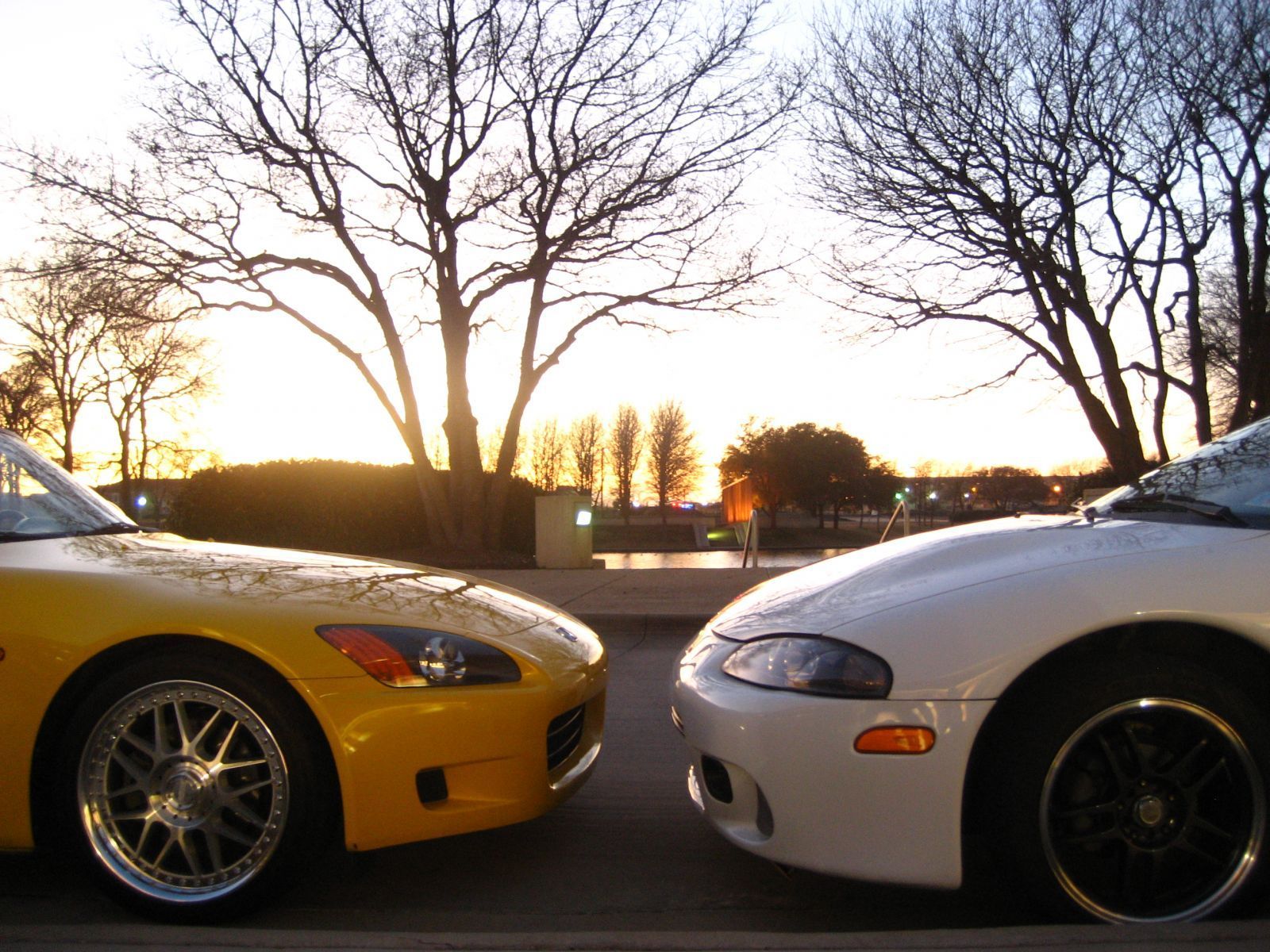

You can tell from my sig.
Here's another one.
You can get to the full sized version and zoom in pretty far. This is an old pic, but they havn't settled any more.

Yea Im trying to see the one from your sig ... it kinda resembles my sitting but I just wanted to double check .. do you have any more? Especially close up to get a good idea?
Also did you rub? If so what di dyou do about ti? thanks
