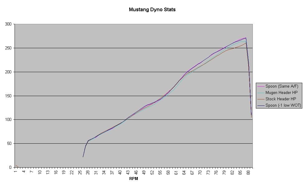

it took awhile, but this is what i have found.
after putting on the mugen, i started getting some detonation issues above 8k, so we added fuel mechanically to richen the top, and dropped the lowend a little with the VAFC. without spending lots of time ($$$) on the dyno, we saw about the same below 4300, drop in midrange and better highend than stock, opposite of NA results.
i swapped in a spoon header and made no adjustments for fuel/vafc. ambient temperature was about 15-20 degrees warmer than when i did the mugen dyno. up to around 4700 it was the same as stock/mugen, started to gain, then dropped off between 5000 and 6200, for a little going slightly lower than stock, but always above mugen. after 6300 it rocked.
i felt that it was still running rich in the low WOT, and it was throwing some black smoke at the end, so i leaned it -1 in low, and -1 above 7500 and did 1 more pull. this got me a little better on the low end, but the same, to slightly worse on the high end.
since i have the greddy emange unit coming in, it was not worth trying to squeeze more out of it at this time.
i have not seen other dyno charts to determine if the 5000 to 6500 range is a characteristic of the spoon header + FI, but from reading some other threads with people trying to explain things, it may be. once the emanage is on, i will be trying to smooth that out.
end decision, for my SC application (comptech for sure and i would assume vortech as well) spoon is definitely better than stock or mugen.

Now, if you could get one of Comptech's headers, we could see what the difference in design does. Thanks for posting.
