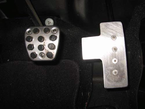

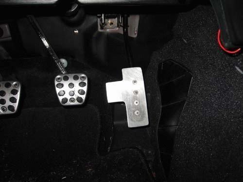

I have difficulty h&t in the S so i made this:
Old Feb 18, 2002 | 07:47 AM
negcamber's Avatar
Posts: 8,821
From: Jacksonville, FL
That's very slick!
Note for the autocrossers out there that pedal mods are not legal in stock categories.
