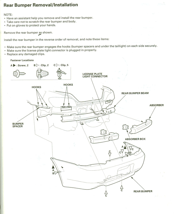

I need assembly instructions on the rear bumper. I got a new one because my old one had been in an accident. Whatever body shop that did the repairs did a halfass job and lost many bolts clips screws. Not knowing what I was missing I ordered everything (about 30 nuts bolts grommets). Can someone scan the bumper assembly intructions and post for me?

Not the pages from Helms, but I'm sure it will help.
http://www.hondaautomotiveparts.com/auto/j...catcgry5=BUMPER

does help a little, but a little confusing. what piece goes into #24, 27 or 43 and is it a push in clip or a screw? Can someone go check for me?

Here you go:
