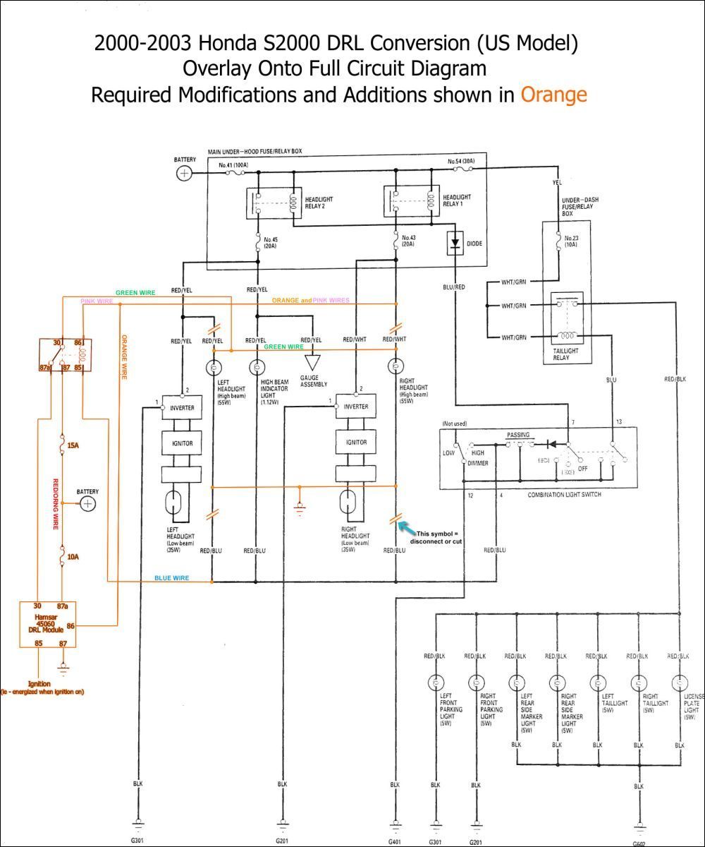

I want to put a DRL module into my 04, but would like to know if this circuit diagram changed any after 2003. It's unlikely that there was a change, but it's always nice to know in advance. The diagram is lifted from this thread describing a DRL installation:
https://www.s2ki.com/forums/index.ph...&f=22&t=192698
Any help would be appreciated.
