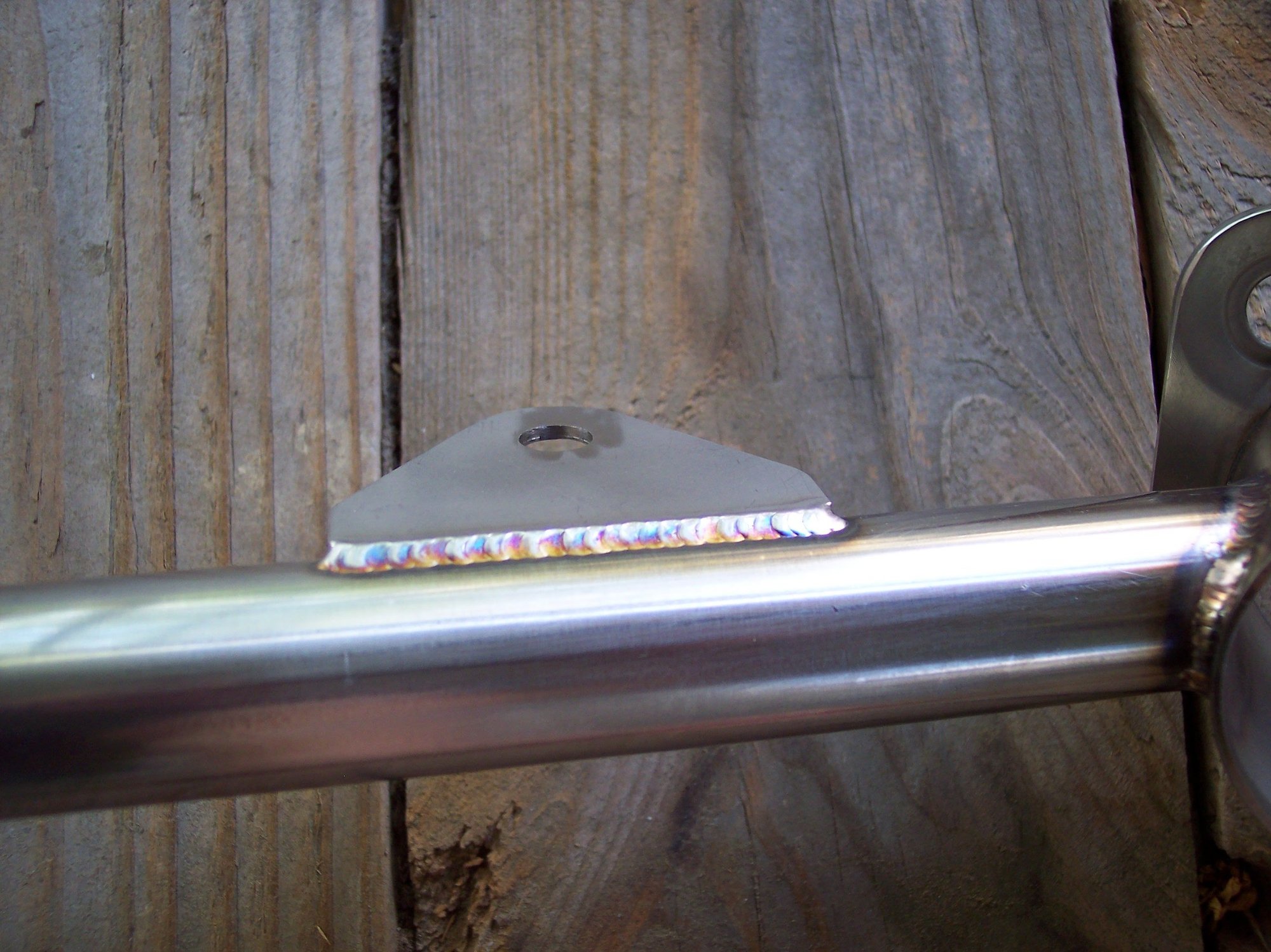

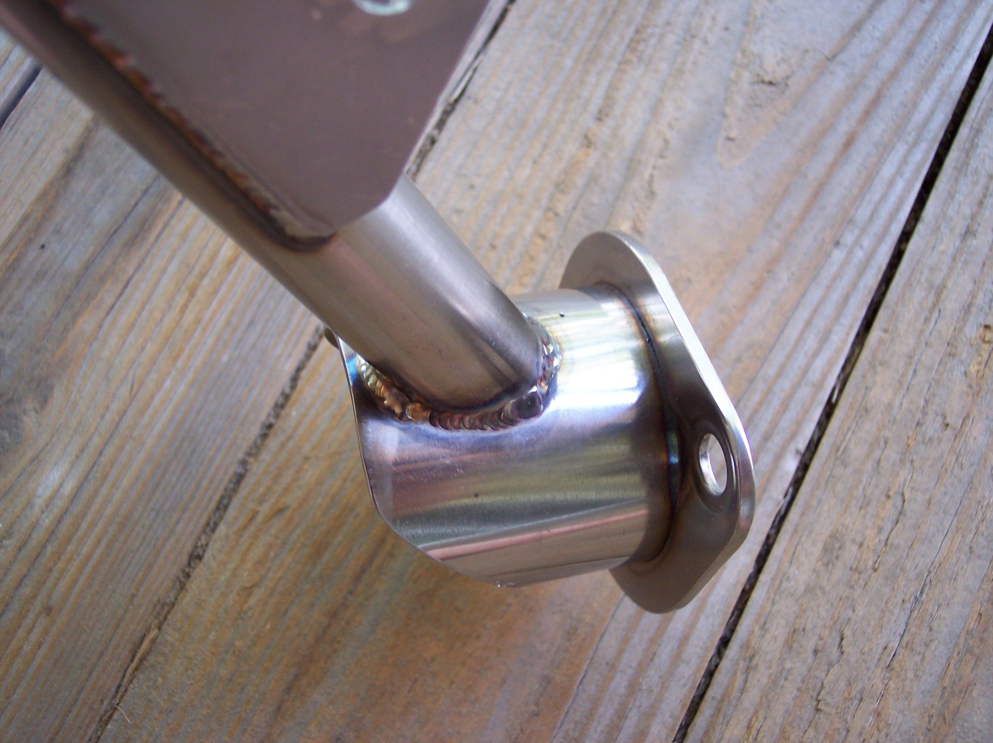

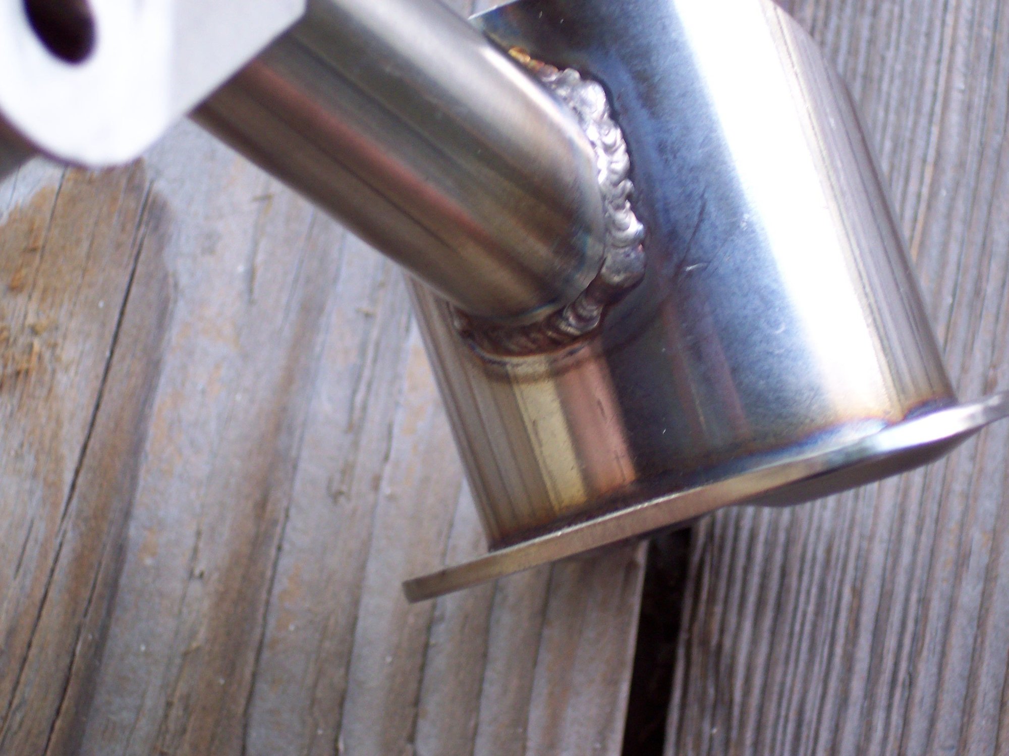

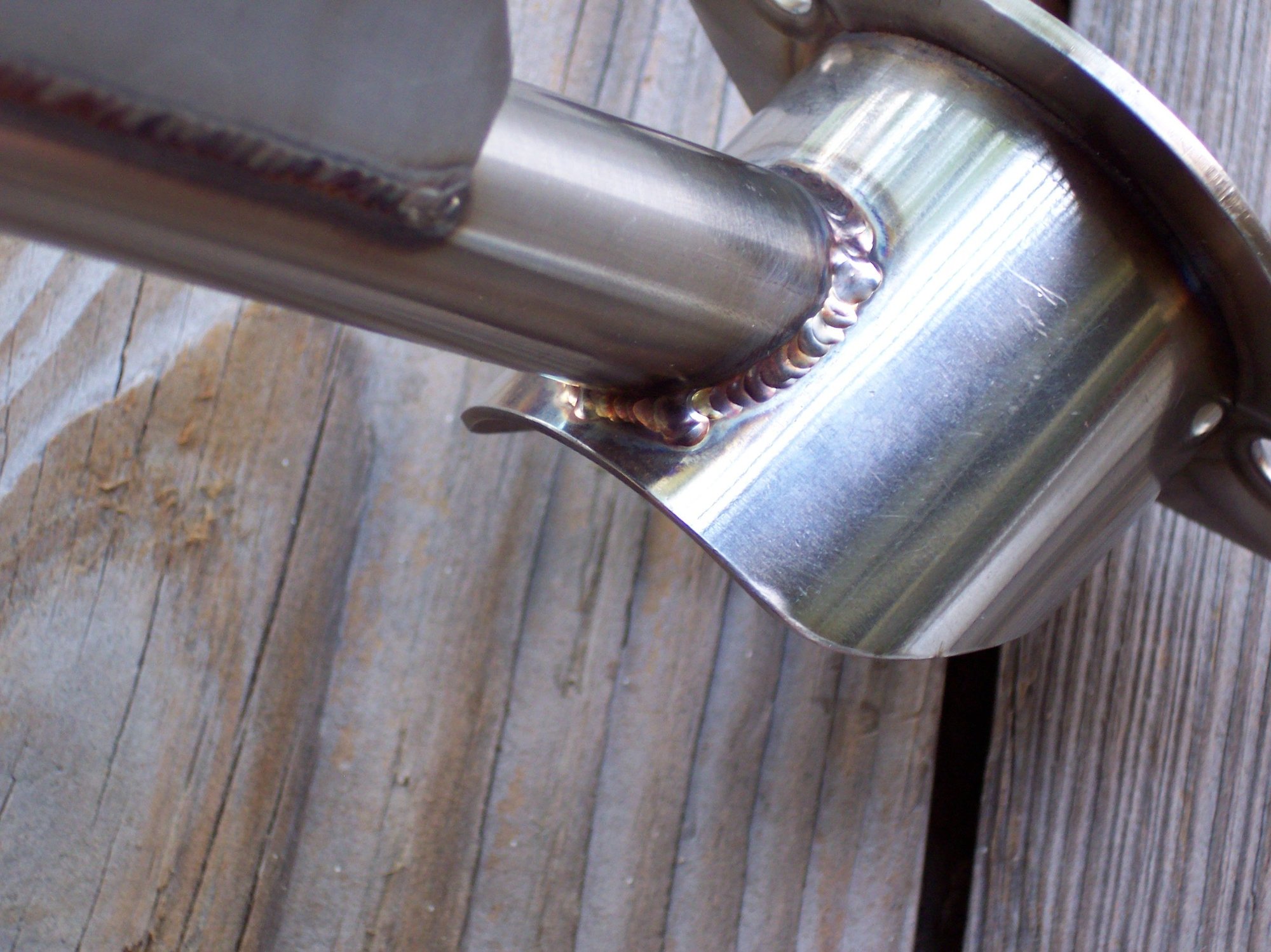

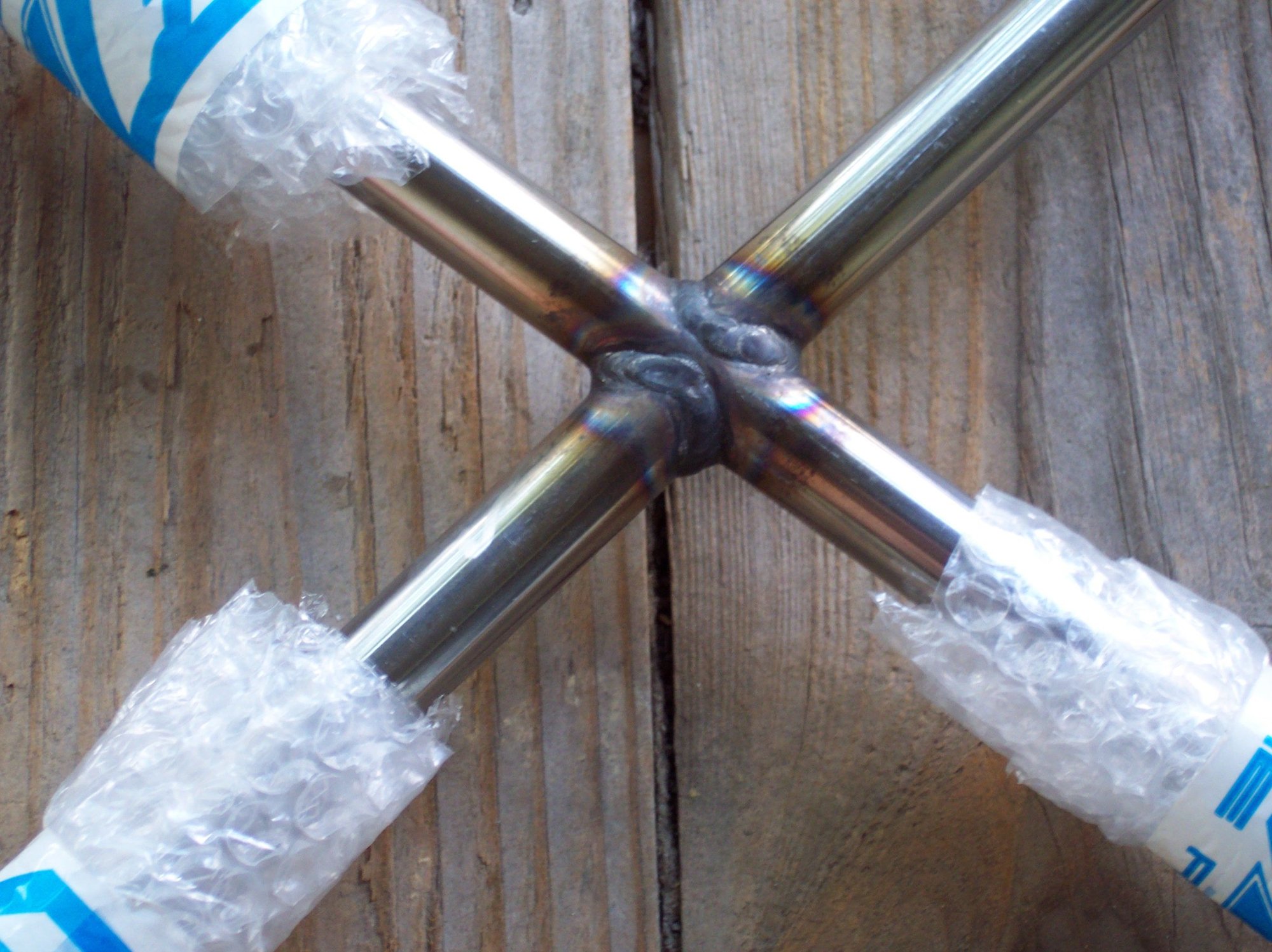

Poor quality welds on STB + missing T1R sticker = my suspicion of a fake.

Posts: 1,014
From: dallas, texas
the welds in all the pics but the 4th are okay.
the ones at the x junction are mig or arc welds over broken tigs....you can see two distinct heat stains.
