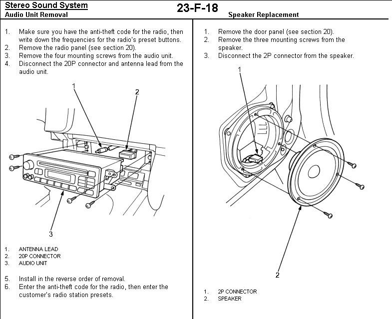

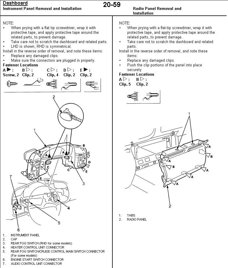

My righr speakers are cuuting out, but notice that if I slap the head unit on the passenger side tunnel, the speakers would come back to life....or it would sometimes cut out when taking a sharp turn or over a bump....I'm guessing a loose wire or connector in the back....sometimes when I apply some pressure to the head unit, the speakers would come back on line. I want to investigate whats going on behind the head unit and fix it....anyone know the steps to remove the unit and look into the back?

hang on a sec and I'll post some pics for you
Old Dec 12, 2003 | 09:44 AM
3ngin33r1's Avatar
Posts: 16,231
From: Kingston, WA
Just the right side of this one, no need to pull instruments.
Old Dec 12, 2003 | 09:45 AM
3ngin33r1's Avatar
Posts: 16,231
From: Kingston, WA

I need to replace my radio door with the 04 door but don't know how. I see your picture post, and thanks, but don't understand where specifically to pry. Can you post a few details. Thanks.
