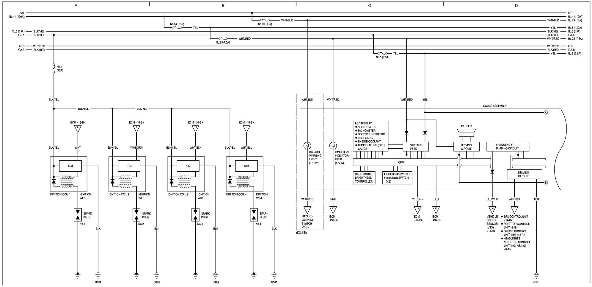

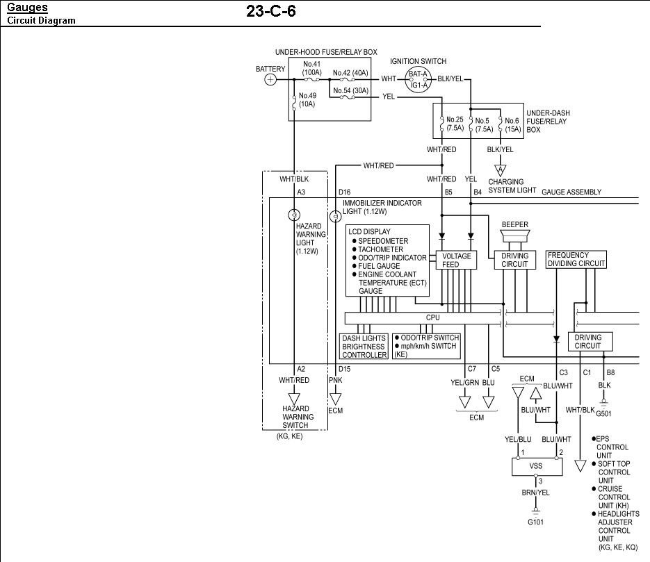

Here you go:

some of you guys are soooo funny, remove the key...sorry i cannot comprehend how to do this from a diagram of wiring....i was looking for someone who has tired of the chimes and removed the noise by pulling a fuse or disconnecting a wire or something like that...simple...so that this mod does not change anything else. i guess i will have to keep searching.

Sorry you couldn't tell from the diagram but it's about the only way that I know of to show you where the beeper is at. It appears that it is IN the gauge cluster.

I wouldn't go under, I'd go in. Remove the gauge cluster and try to locate it.
