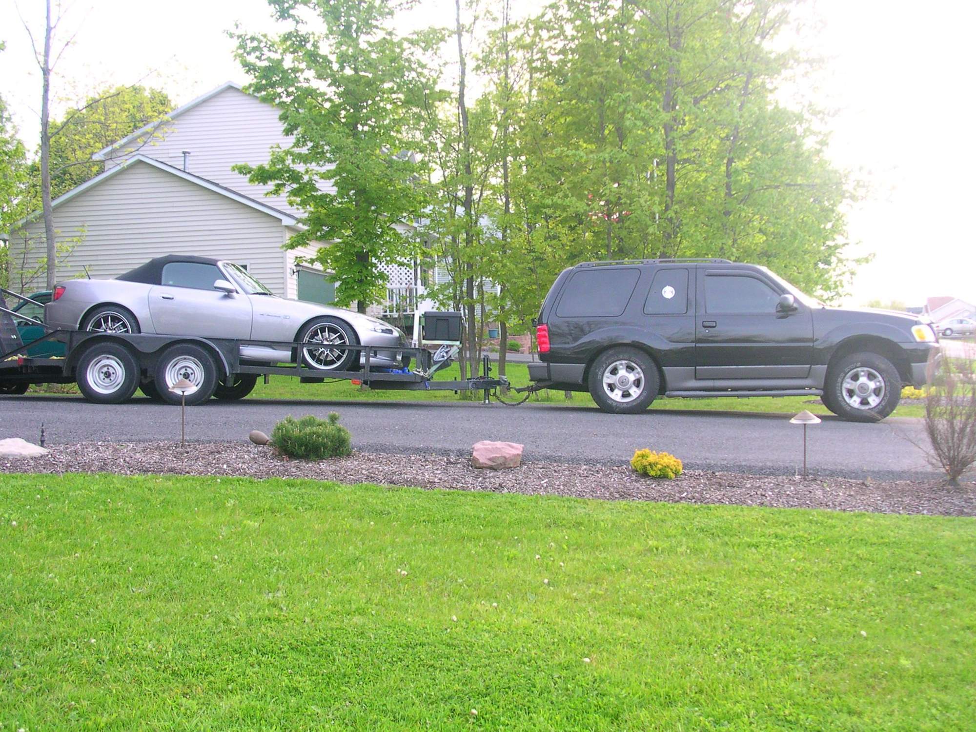

Thanks for the info and photos of the trailer. It looks like the U-Haul is very similar. The U-Haul place wants me to bring the car to them. I'd rather take it to my place and load it there. I was thinking if I don't have long boards, I can put the ramps up on a grassy area near my place (it's about 8-10" higher than the street, but has a flat area I can easily drive onto from the street) to get the same effect. Thanks again. I was dreading having to come back to LA to drive the S2K back to San Francisco. Much rather trailer her up there.
