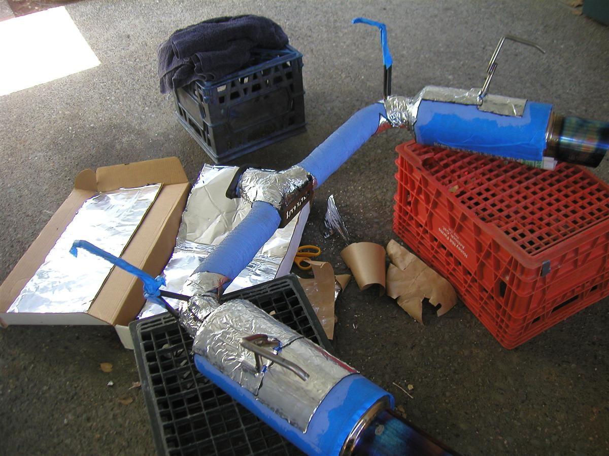

I had a chance to compare my magnaflows and an invidia side by side and I noticed the Invidia had an octave LOWER pitch that really rounded out the sound that I was looking for. I have extensively droneproofed my S, as detailed here
Dynamat / Quietcoat =>drone (3-5K RPM) killer
https://www.s2ki.com/forums/index.php?showtopic=275932
and I had experimented on directly droneproofing my resonatorless magnaflows by heatwrapping here
Heatwrap your catback
https://www.s2ki.com/forums/index.php?showtopic=343230
Here are some before and after car pics
I found a used Invidia in good shape and a GREAT price and went to work.
Here I JetHot coated the runners
Here is the end product
I LOVE the tapered ends and great finish details that the Invidia has
The Tips really like the heat
I found from my previous heatwrapping of the exhaust, that it was still too HOT on the pipe and coatings would turn brittle and fall off. I also wanted to END any fear of rust associated with prolonged heatwrapping, so I layered
1. JetHot Coating the runners.
2. Heatwrap
3. DAMPLIFIER PRO
4. Spectrum firewall

That's the left tip which gets most of the flow from this design. With all the heatwrap and insulation, the tips get extremely hot now.
