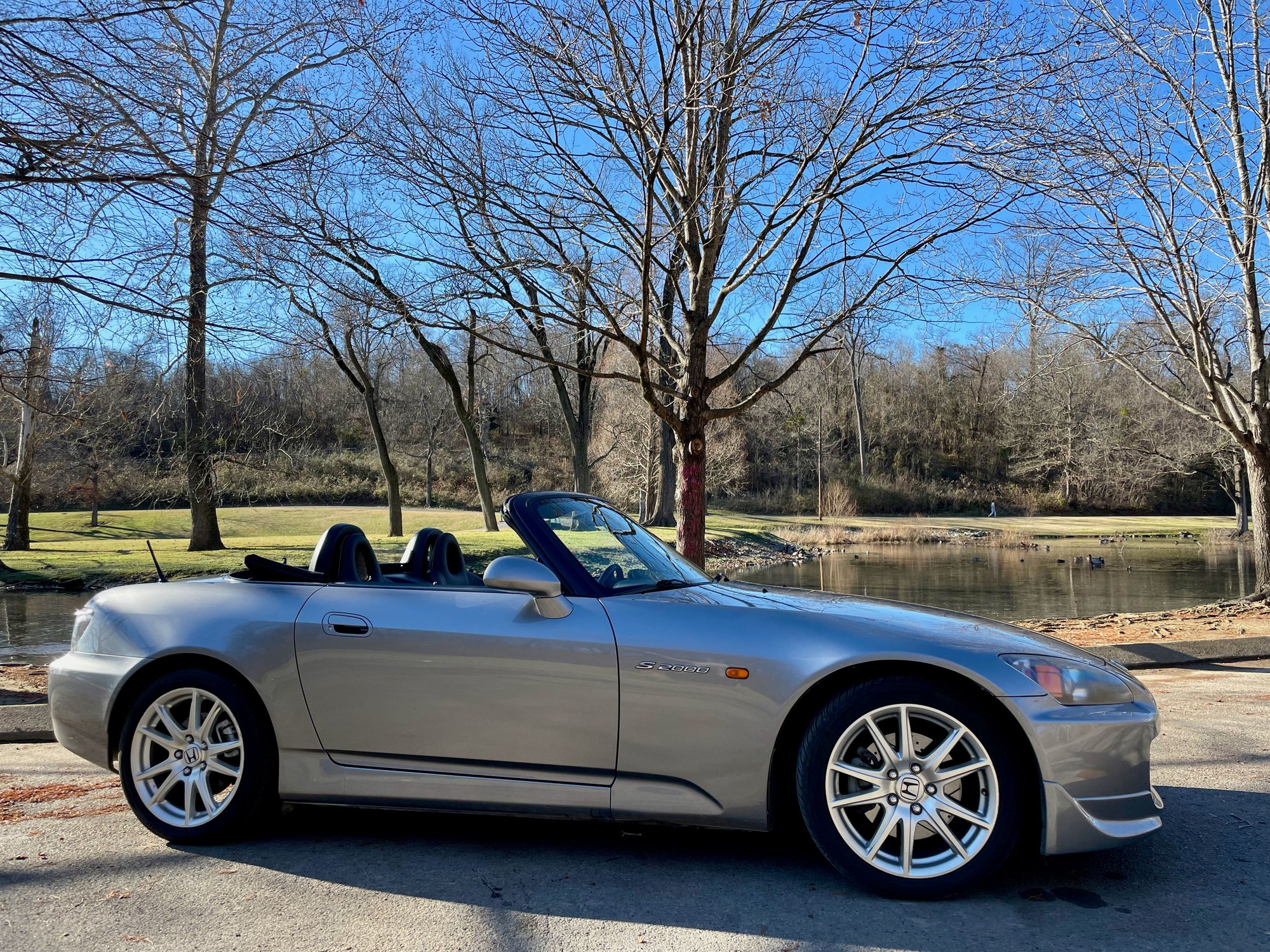

Hi everyone, bought my first S2000 a couple months ago. I've always wanted one of these and now I have one!! It’s an 05 with 113k miles. It’s largely stock and I’m working on a few things that need to be addressed. One of them is the shifting.

Just motor and transmission mounts were changed out? Not really sure how common that is to just do that, or were a lot of things done to the car and everything else brought back to stock? The car looks beautiful but the bottom of the door panel alignment kind of jumps out at me, just sayin. If all the vins are there probably a non issue.

I think the door gap is normal. Maybe more than you'd prefer but I think it looks standard. Nice looking car.
