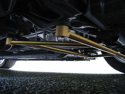

IIRC it is all in the hand book - but I am sure there are six jacking points
Two on either sill, one on the bottom of the rear diff (as already pointed out) and one just in front of my x brace on the subframe in the pic below
One trick I have heard used is to raise the car height by driving it on to some planks of wood. This allows more access to get the trolly jack under it! Just make sure it comes back down on to the planks
