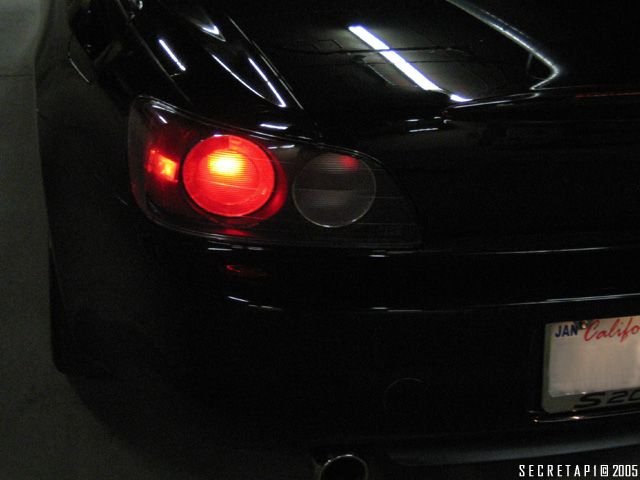

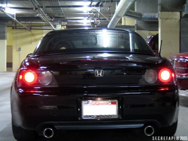

Not many pics at the moment because it's difficult to capture the difference on camera. I think the videos tell it best, but incase anyone is too lazy to wait for the videos:
LED installed
The LEDs light up the reflectors pretty well.
This the comparison. Can you guess which side has the LED bulb?

I'm guessing the driver's side...the color seems richer (and only that side is pictured in one of the shots).
I just checked out the videos and they look very nice. The only dissapointment was the brightness of the LED brake lights at night. How does it seem in person? Bright enough to be safe both at night and in the day? Would you mind listing part numbers and prices? Thanks a lot.

I'm working on getting the turn signals to work this week. I'll keep you guys posted on that. Daytime brightness on the LEDs isn't bad, but I'll try to snap some video for you guys to see. I haven't had a chance to see the LEDs against direct sun yet so I don't know how bright they are, but I did drive around all day with it yesterday, and I didn't get rear ended!
As for part #s, I guess I shouldn't put the name of the website where I bought them, but you can obviously see the name in the pics above.
BRAKE/TAIL - 7443-15 (15 LED Red)
*TURN - 1156-A24 (24 LED Amber)
BACKUP - 7440-15 (15 LED White)
*Hold off on getting the turn signal bulbs. They didn't fit correctly, nor did they work after I removed one of the lucking stubs to try to fit them.
If anyone else has had success with getting 1156 bulbs to fit and light up in 1156A sockets, please PM me.
