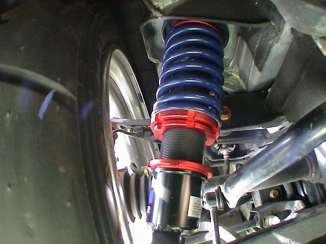

I love my Buddy Club Coil-Overs. Not bouncy at all (but I run them VERY stiff).

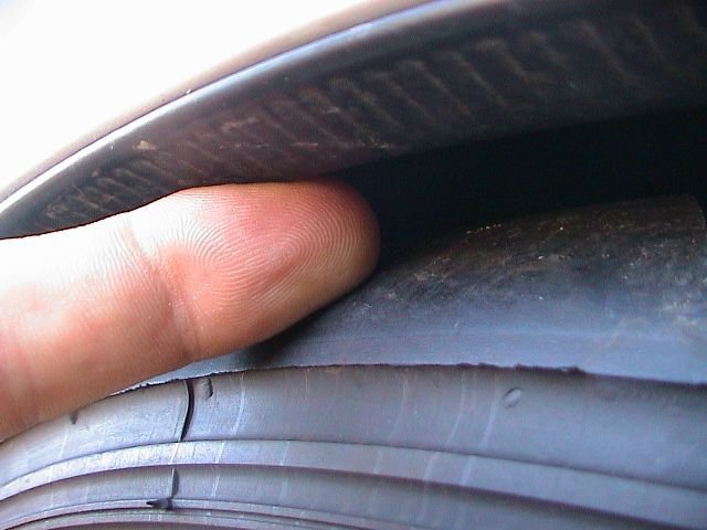

If you dont track your car then coilovers are pointless... I have the Espilers put on my car, and it's a really agressive look

s2000flog how's the handling and the bouncyness, are you riding on stock shocks? The car looks amazing!
