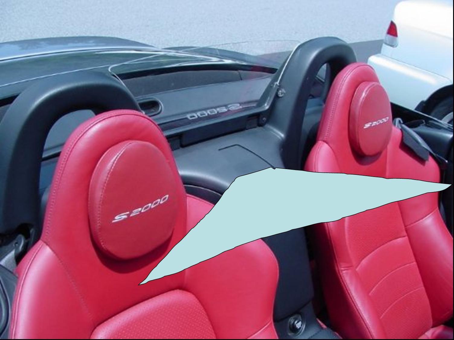

Very familiar with RADAR theory...Plastic will not interfere with the radar waves. They pass right through, especially with thin ABS. Not familiar with your detector to tell if it is rear sensing, but the placement from the pictures looks like you will not receive rear detection if it has that capability because it's line of sight (LOS) below the metal structure of the roof when it is down. It even looks to be below the trunk lid which completely blinds that LOS. You will however continue to receive reflections from signs and other vehicles through the front. Side detection (if able) is also degraded since it is between the roll bars and seats. But you will still recevive those reflections. BTW the reflections are what you want since if it goes off after you're painted, he's gatcha. Basically, anything metalic interferes (including chrome window tinting), ABS (car plastic) will not. Forgive the crude drawing, but this is the coverage you're basically looking at.
Rick...still looks awesome

The rear and side coverage worked pretty much as they did when I had the V1 mounted on the windshield and just in front of the windscreen. But that's impressionistic, not scientific
