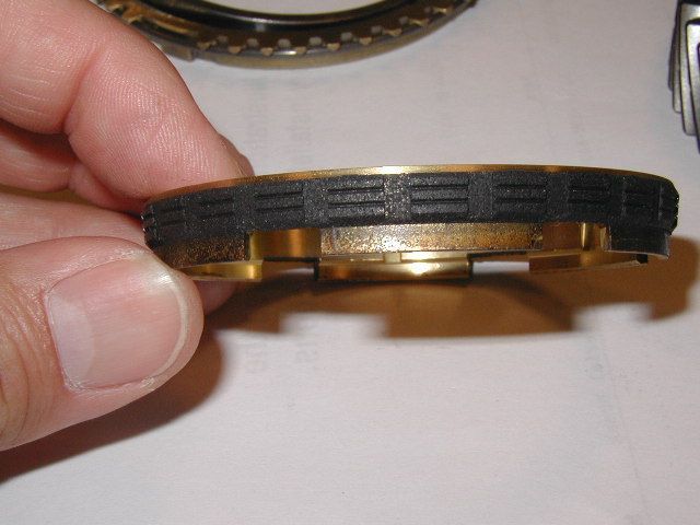

Hi All:
The 04 is just a little more notchy than the 03 when they are cold but the 04 gets much better after it warms up, usually about 4 or 5 shifts.
The brass ring looks like carbon was sprayed on the inside of the ring but I am sure that there is more to it. (Not quite diamond material)
I can email a photo to someone if they could post it.
Woodwork

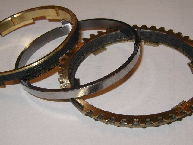

here are the pictures from WoodWork.

A quote from Temple of Vtec . . .
"A good example of this is the new carbon fiber synchromesh for all gears except reverse. The new synchronizer design features a brass ring with a carbon fiber element bonded on the inner surface, resulting in simplified mechanical components, increased synchronizer capacity, improved abrasion resistance, and reduced weight. The weight reduction and increased capacity of the synchronizers directly results in a "smoother and quicker shifting feel". "
See Link for more info.
Erik
