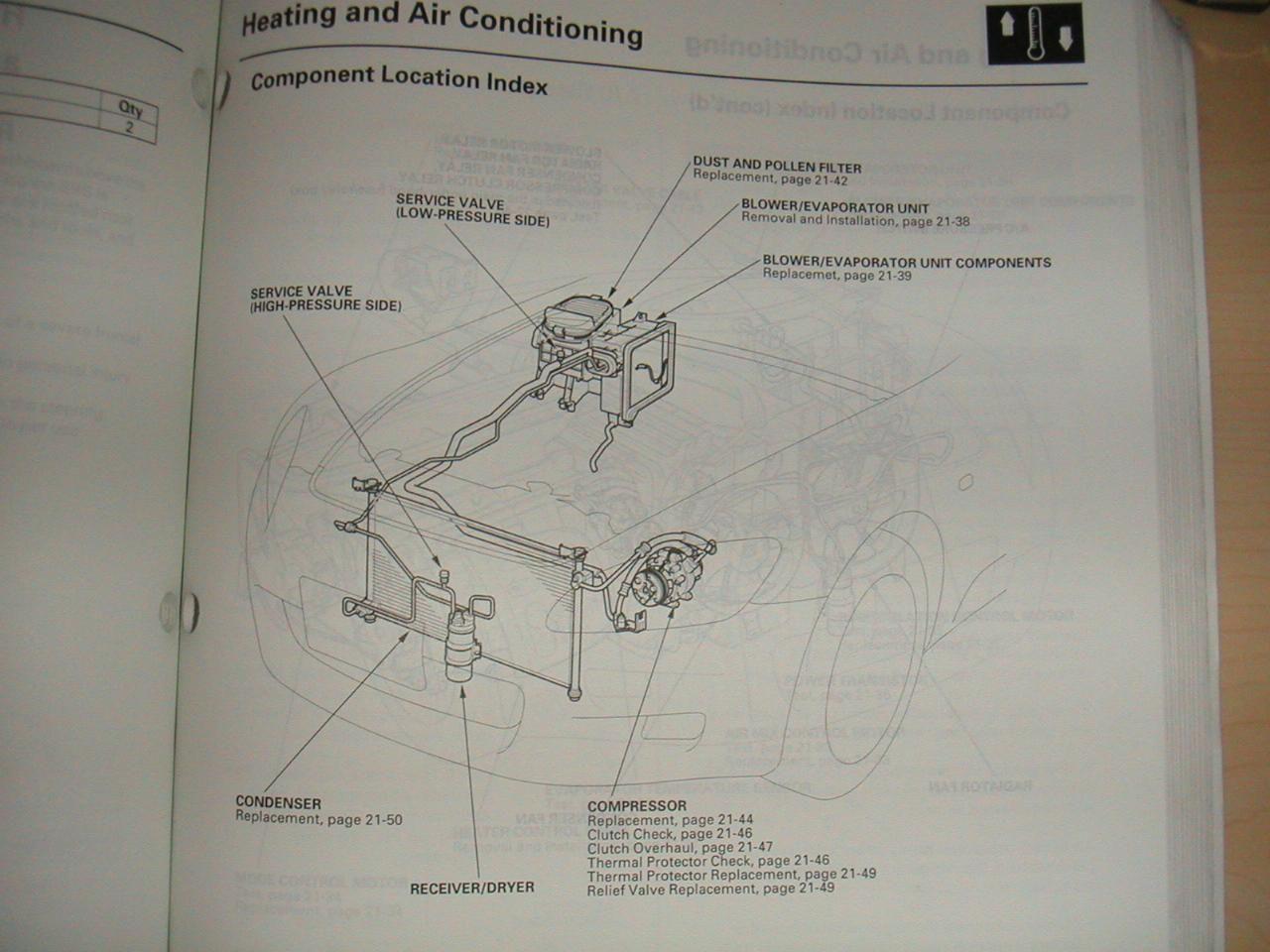

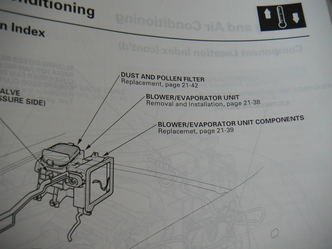

CHeck to see if this little tube (under the Evaporator)is secured and nothing in blocking the tube?
If everthing looks good, then take it to the dealer fot TSB fix!
Some others have the same problem!

Thanks guys - - The manual pics are wonderful
