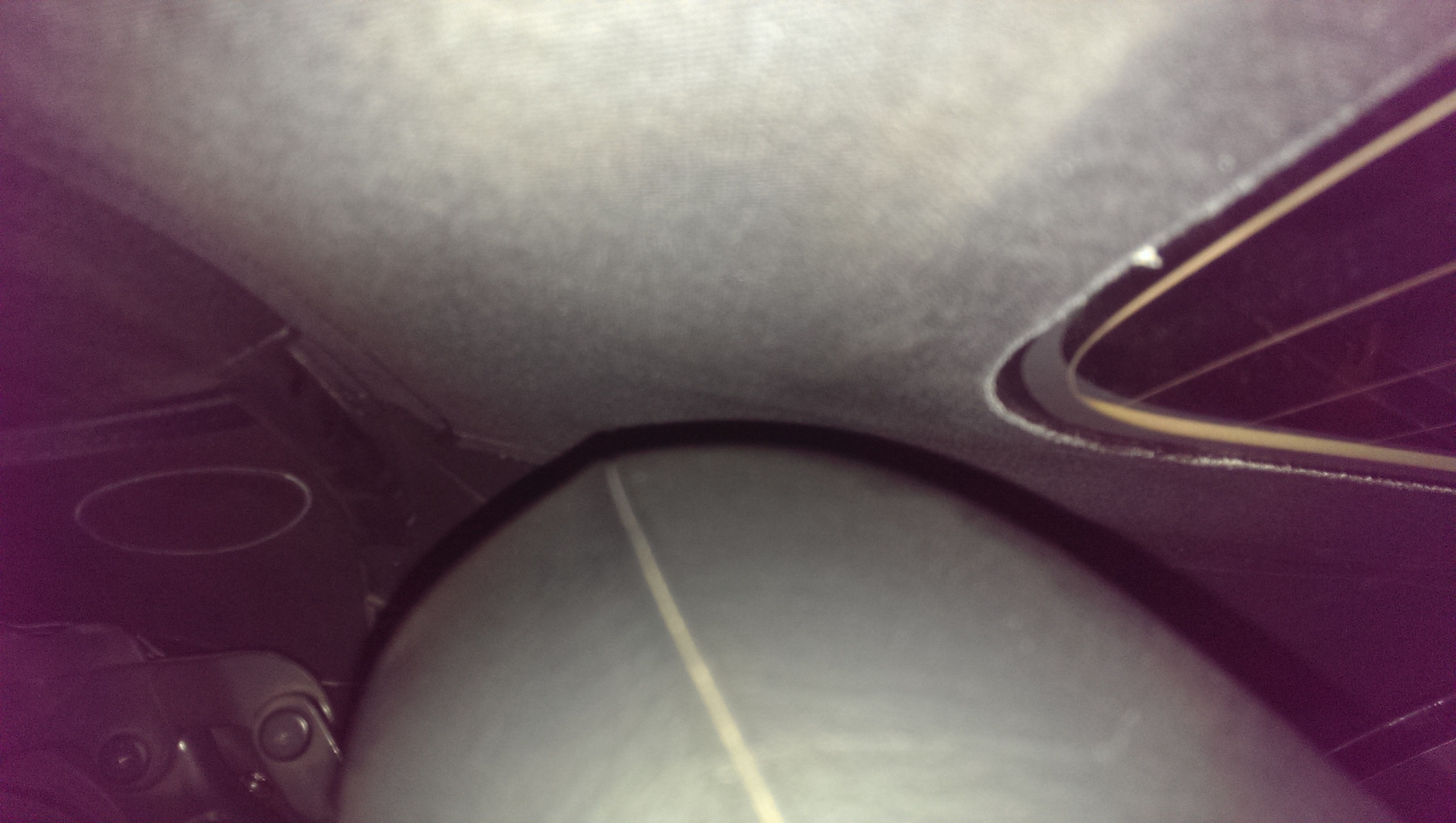

From: Tucson, AZ
Here's a pic from inside. There's a two finger gap between the hoop and the top and it's taut, so you would need to press down to force contact.

Likes: 1,861
Suggestions on how to fix? I'm reluctant to bring it someplace, since it was 'experienced experts' that got it wrong in the first place. Would rather fix it myself, with some guidance on where to start...

From: Tucson, AZ
Pics would be a start. We would need to see what yours is doing to make suggestions. Exterior as well as interior showing the how it is contacting the hoops.
