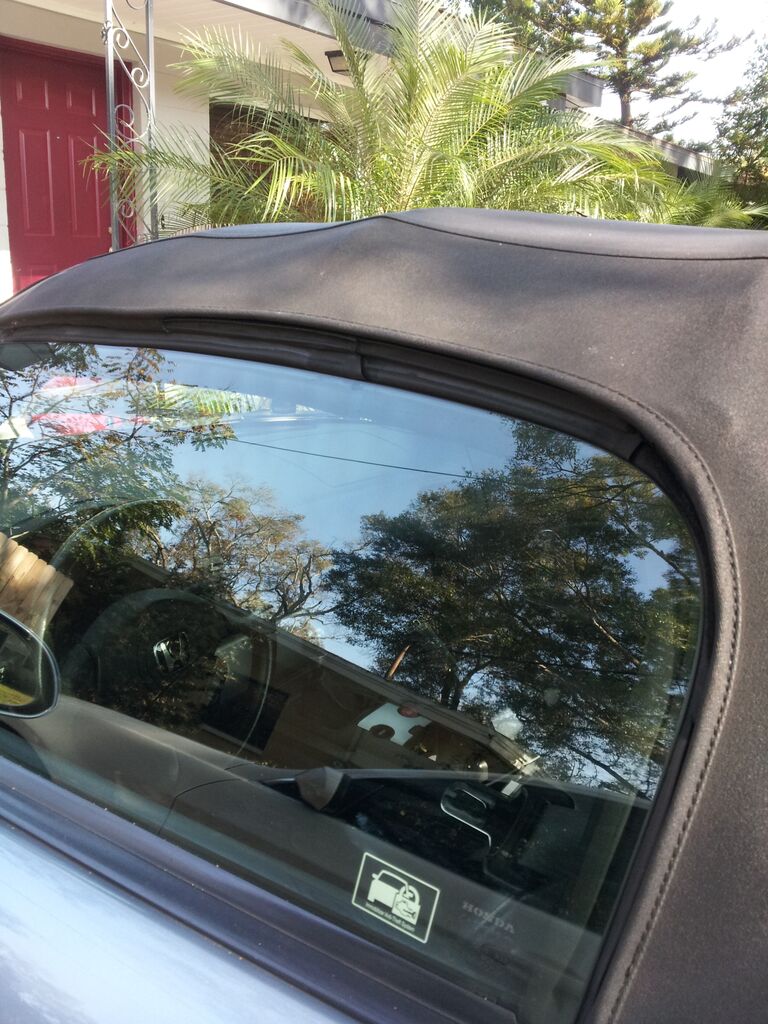

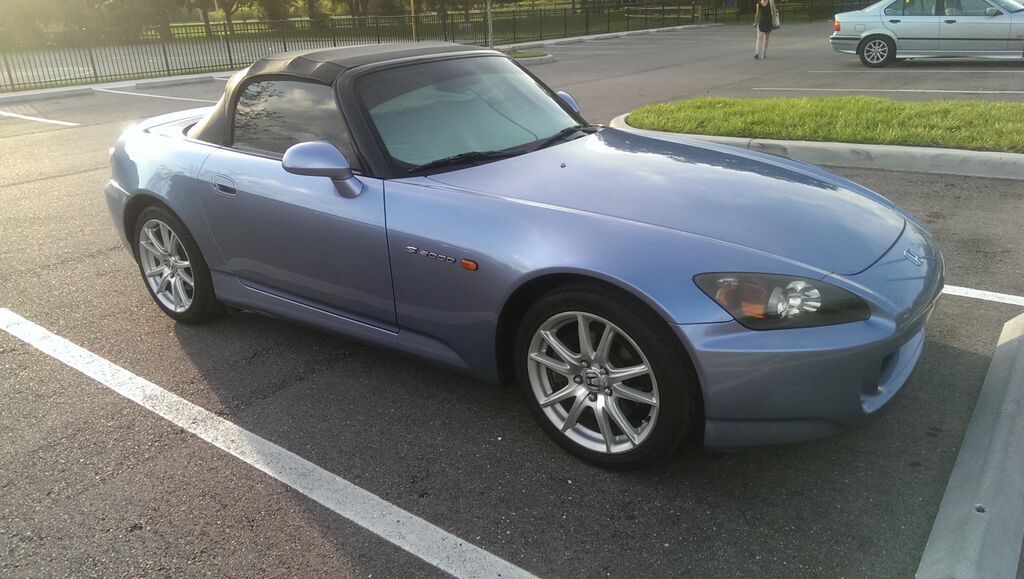

I have a very bad fitting, cheap looking aftermarket top as well. Installed by a cheap previous owner It is the single ugliest thing about the otherwise great car. I'm going to sell the car and get another S with a proper top. Never cheap out on a car!
