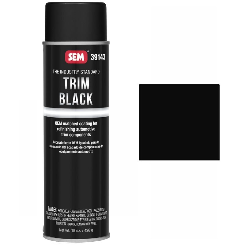

If you're trying to get it to match, a marker might be a better fit unless you found a flat/matte black paint pen.
SEM Trim paint is a good fit for interior repainting, but you'd have to spray. So take it apart and tape it off.
