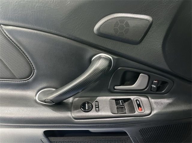

First check safety switch on driver door. If that's not it, post exact symptoms (i.e. is it completely dead, or does it still move under certain conditions).

Now I feel like a Doofus, I had totally forgotten about the safety switch and that was the problem.
I'm the original owner and have owned mine since 2/02 so I should have known, but obviously I've kept it on and never turned it off for long enough to have forgotten it even existed.
Thanx for the reminder and glad it wasn't more.

Where is this safety switch?
Just forward of the window switches on the driver door
It's the rocker switch with the red bit with 'ON' written on it.
