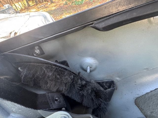

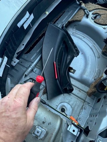

Another interesting aspect are those small long rubber pieces found in the drain buckets. I've included a picture where someone is holding them near the front corners of the car. Thats where I found them as well. I saw the old double sided tape, removed it and replaced that tape. Had to take a guess as to orientation and location of those little pieces. Hopefully I got it right, but haven't received any answers as to where they go.
Picture grabbed from one of the installations showing the small molding piece
You can see where i mounted that little piece, the giveaway being the lighter colored, gray. double sided tape.  The brushes also indicate orientation.

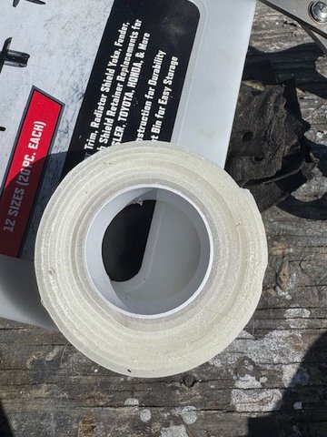

Tape I used
Tape I used

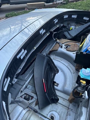

Tape in place covering the holes on outside, inside, inside and outside of the rainrail
tool used to poke through the tape to mount the studs.  Need this as you can't push the studs through that tape
I did not go with rivets. Although recommended in several threads. I'll go with HarryD's review of his installation where he used some very expensive 3M sealing tape. He bought for $18 and change if I recall and it is now $1600 and change on Amazon. I think that's a mistake, but on other sites the tape is closing on $100 plus. That tape is 1mm and the tape I used is 2mm. Much cheaper. Very sticky and the adhesive actually seems to flow in this weather.
So, no rivets. Also going with the reviews on Miata.net where those Miata brethren mentioned that the rivets are used at the factory to make installation easier. Makes sense. I'll be testing for leaks tomorrow.
Oh yeah, none of the rivets holes were used by the shop. None sealed up so leaks abounded. Yeah, I know that a rivet isn't waterproof either. I like this 3M tape to seal this kind of stuff. You do have to poke holes through the tape to mount the rain rail to the studs, but the glue seems to flow around the hole and stud from what I'm seeing. This stuff is sticky!
