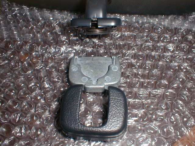

So is the "mount" still on the window? If them metal piece came off the window, you will need to have a glass installer EPOXY it back on (better than adhesive).
I'll go get my mirror assembly (it's out of the car) and take some pictures so you can see how it goes back together.

Oh, that's different. All the car's I've worked on in this area, had some kind of set screw, usually an allen head set screw, that locked the mirror on to the metal piece that glued to the glass. Does you're have this? If so, just put the mirror back on and tighted the set screw. It doesn't need to be "real" tight, just a little snug.

Ooops, I think I showed the metal button upside down
The pictures should help anyway...

i knew i had to take the screw off to put the washer in.
its screwed on pretty tight.
