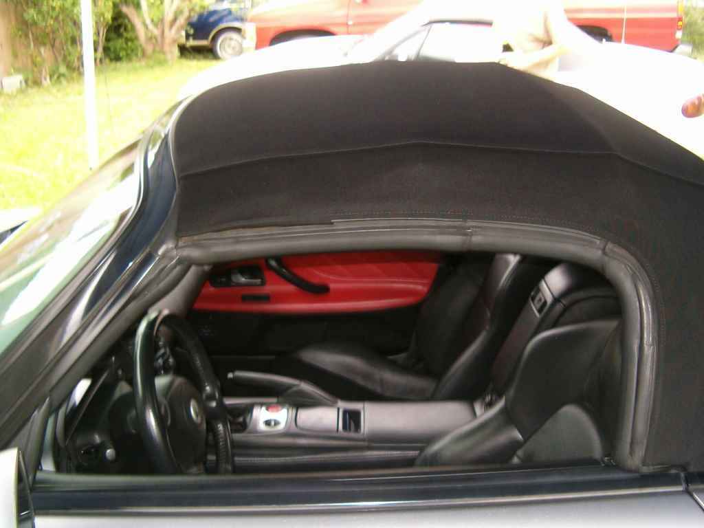

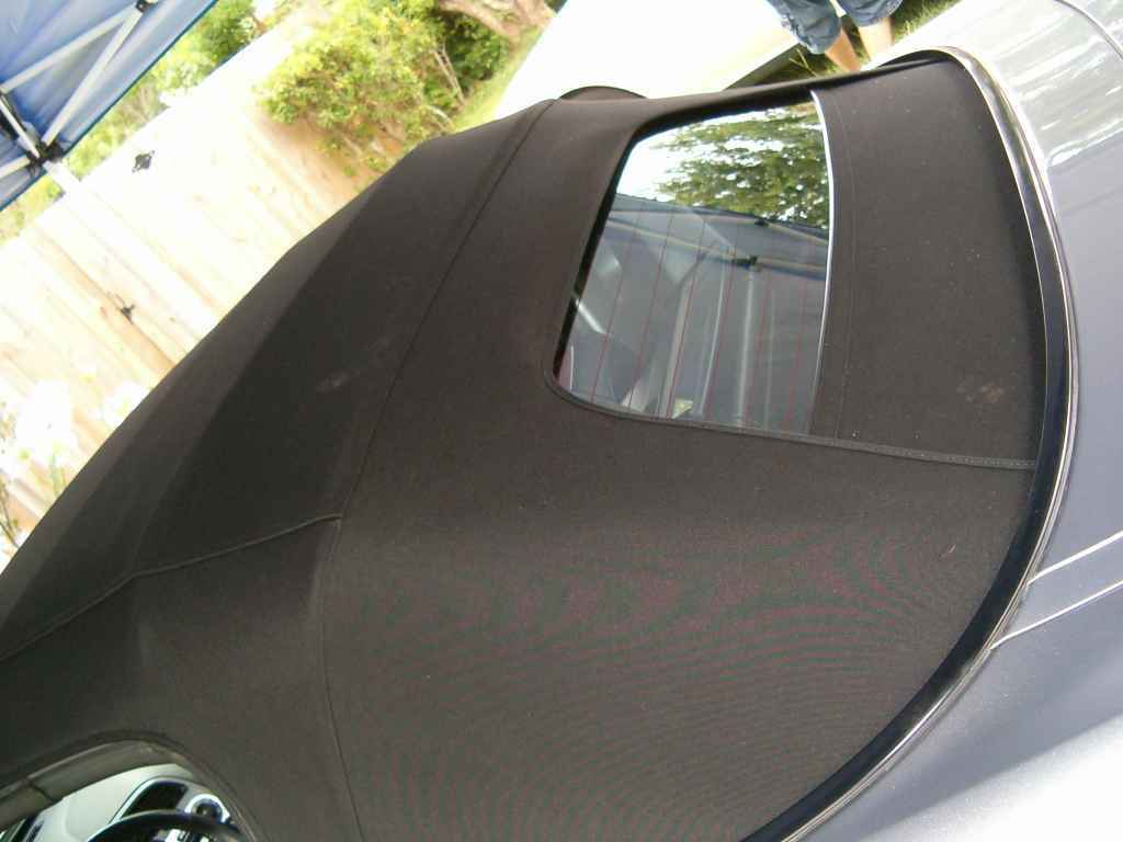

I can report that the fit of the EZ-ON top is very good. It will likely improve a bit over the next few top-up days.
Here are some pics of the top, installed.
What appears to be discoloration in this picture is just a trick of the light. The top is uniformly black.
And those spots near the rear window are just cat-paw tracks.
