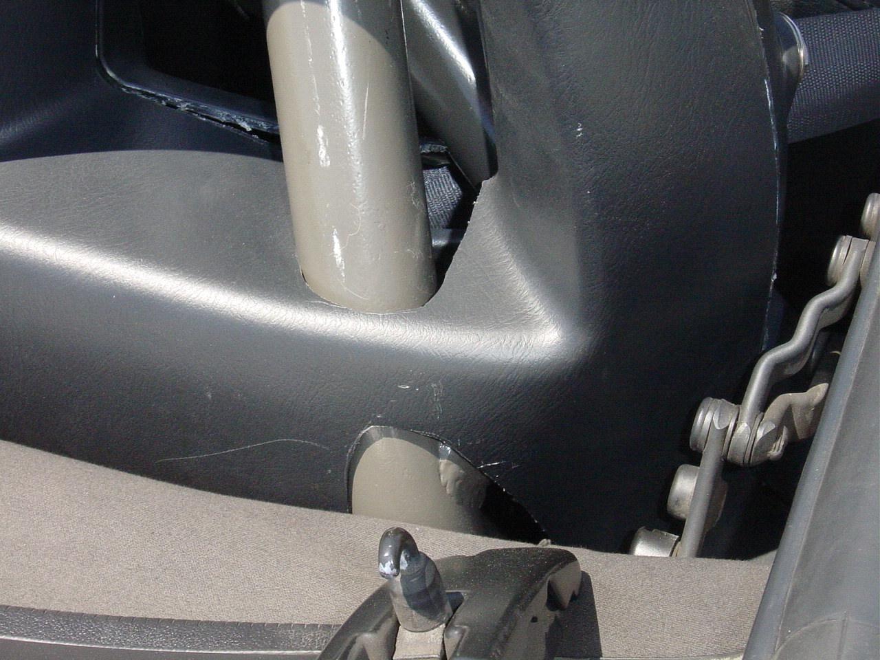

Check out the bitterman bar.. you can find it on a search.
Trying to bolt something on to the stock bars would NOT be safe. I sure wouldn't trust it.

I'd argue the statment about the bitterman bar leaves the interior dramatically changed.
You can actually put the stock plastic hoops back in after installing the bar. They have to be cut some, but look just fine.

What krazik says is true. Recent customers for the Bitterman Rollbar have put the plastic back in with some cutting. If you want more information, please contact me at aaron@speedventures.net or 323-461-4795.
I'll try to get DavePK to post pictures of his install.

They have been posted... not by bitterman as it's a pretty recent mod. Getting them now.

First off.. Here's my car w/ the roll bar in and interior not replaced yet.
next here's Dave PK's. his was somewhat hack job was the "First" attempt. Mine will be the second attempt and should be cleaner. (learning from other's mistakes)
In a nutshell NO aftermarket roll bar is going to get you any extra protection without some sacrifice to the interior. But you can make it look pretty close to stock with the bitterman bar.
