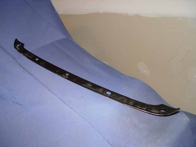

While I was ordering from 4IG I also ordered a carbing plate to cover the front of the motor and the radiator. You can see the CAI and the rad plate in the first pic here.
In order to install the rad plate I had to remove this piece from under the bumper attachment points.
I have had some issues with getting the hood to latch properly. I will have to fiddle with the latch mechanism to make it work correctly.
