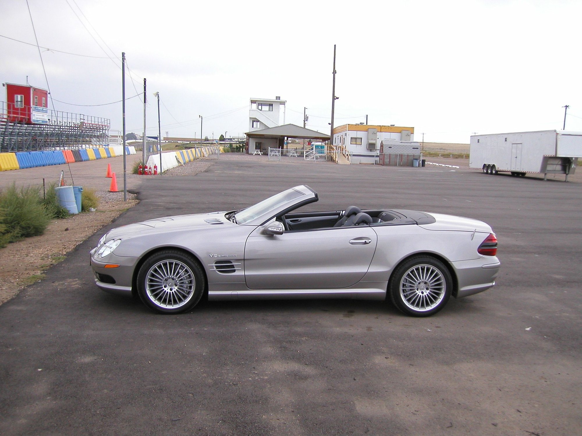

About 1 month ago I raced with a SL55 AMG, he was faster (twice the HP of the S)and could stop quicker but for some reason the guy could not shake me, oh and buy the way his car cost 5x as much. So what! The guy did not know how to drive his new car, do you see my point? It is not the car that matters (so much) it is the driver.

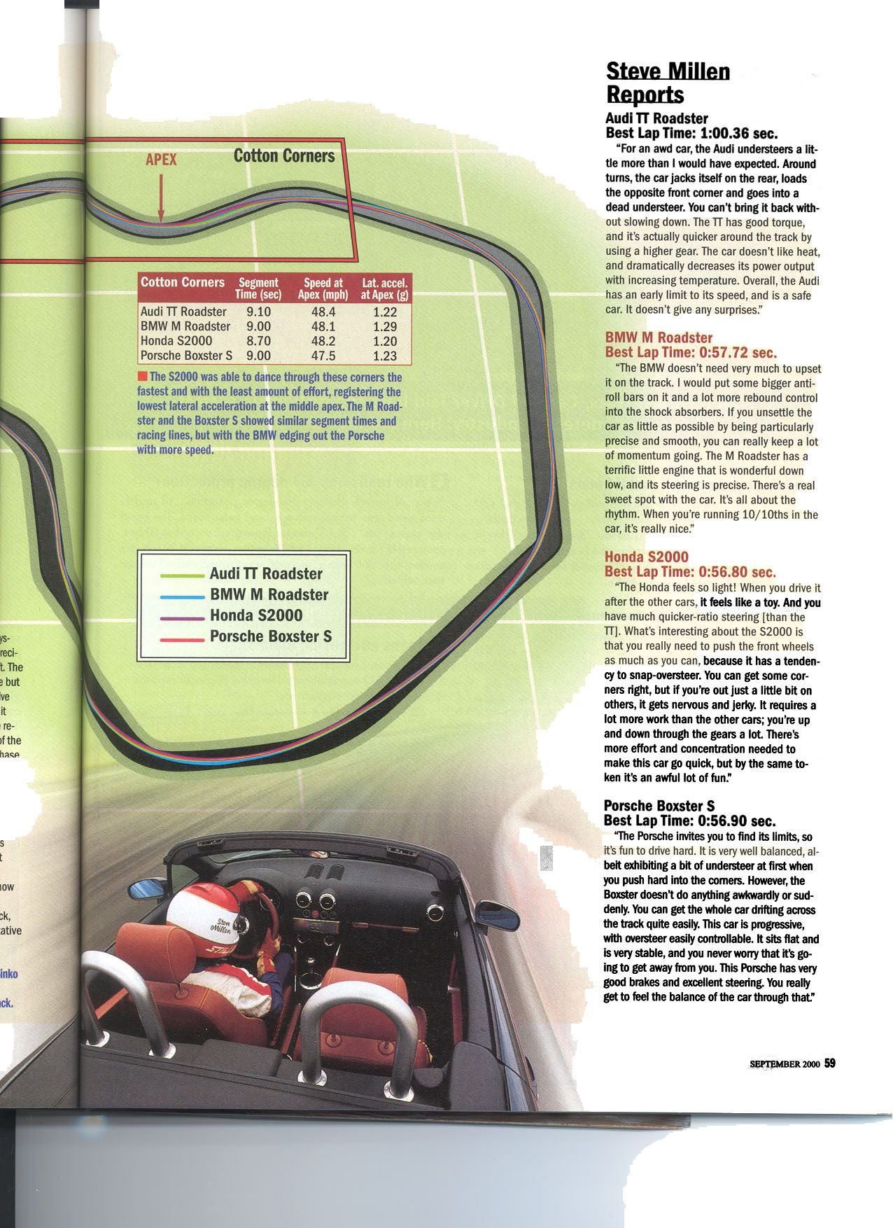

If you still do not get it maybe this will help. I know it's a roadster and not a coupe but it's only for illustration purposes. I'm only trying to help you realize that you can drive your S faster with out dumping a ton of money into it. The S is going to require more from you as a driver, that's what makes it so much fun. Change what you are doing behind the wheel and it will make a world of difference.
