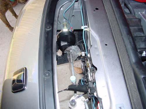

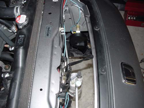

I didn't like seeing the horns from the front of the car so I placed mine where the red circles are...

I took the air guide off and installed a single "blaster" horn - supposed to be 138db - for sure is louder than the OEM horn and tons better "tone".
I HATE THAT AIR GUIDE! I was wishing I just took the bumper off! It was such a pain to get the air guide off and back on. My hands and wrists are too wide to fit in there good (and are now all chewed up). But it is done - sounds tons better. I broke the connector off the old horn and soldered a wire w/connector onto it. In a pinch, I could get another OEM horn and connect it right up since I made no changes to the car wiring/connector.

More pics here
These are FIAMM electrostatic horns and plenty loud and immediate. I removed the stock horn and put a relay there. The wire to the stock horn triggers the relay and I have a think wire running direct from the battery (with an inline fuse). The horns come with a metal bracket that nicely attaches to the bolts on either side. Massive improvement.
