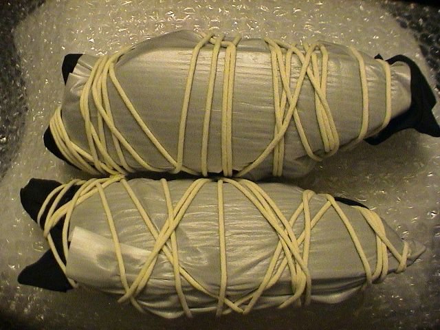

To accomplish this, I chose not to follow the subscribed technique of using the wet towel. Instead, I used a DRY towel, and carefully monitored it for signs of burning.
I used the same towel 6 times, with no adverse effects, other than a slight scorching/color change around the edges.
I couldn't find any clamps that I thought would be appropriate, so I bound them tightly with 3/8 inch cotton sash cord, after protecting them with a cotton pillow case, and some padding:
Hope these tips help!
